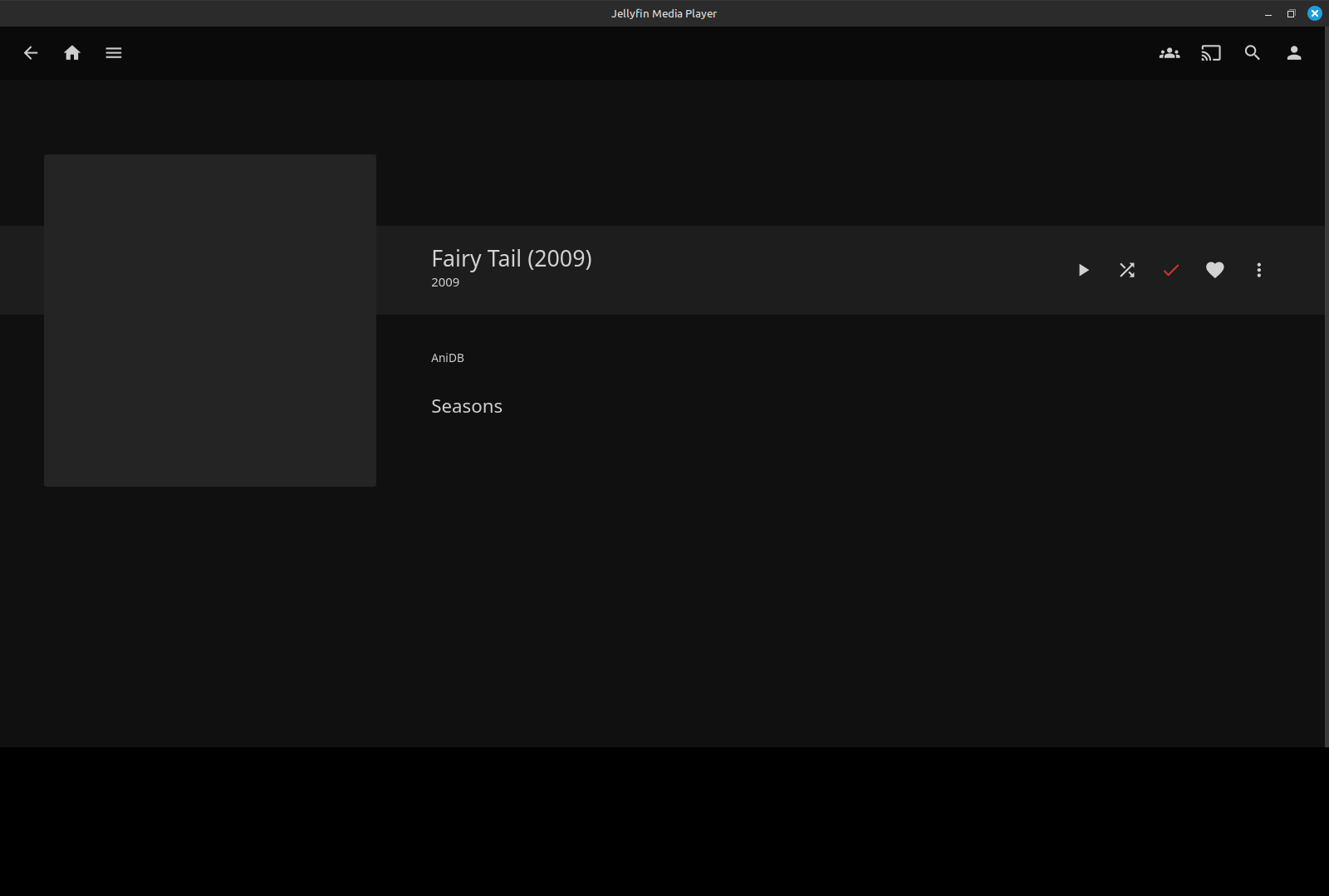

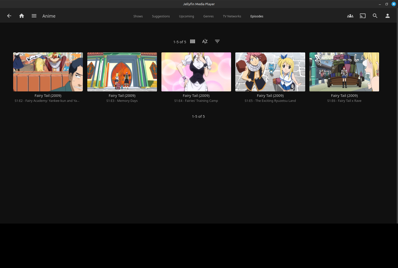

    I have a weird issue that I can't find a solution for, when I add a Show to my Jellyfin server it does not fully find them I think, they don't turn up under the Show but I can see the indual episodes of said show on the separate Episode tag,
    I am running this on Linux mint btw
    Edit: Added screenshots of the issue

    Can you share how you named the folders and files on your drives?
    Then can you share how you linked the files to the library in Jellyfin?

    The drive it self is mounted to mnt
    Anime
    ---Fairy Tail (2009)
    ------Season 1
    ---------Fairy Tail S1E1.mkv
    ---------Fairy Tail S1E2.mkv
    Books
    ---Audiobooks
    ------HarryPotter
    ---------ChapterName.m4b
    is how the folders and files are named, and I linked them through the library tab under Dashboard, Add Media Library, Content type Shows (Books for the book stuff ofcourse) and clicked the Folders + button and linked it too /mnt/Media/Anime
    2025-03-14, 01:18 PM
    Try adding a leading zero in the file names.
    "S01E01", etc. Not sure if that will make a difference or not.

    Which metadata providers do you have enabled. I looked again at your initial screenshots and I see only "anidb". I generally recommend against using AniDB as a primary or sole metadata provider. TMDB is my recommended metadata provider.
