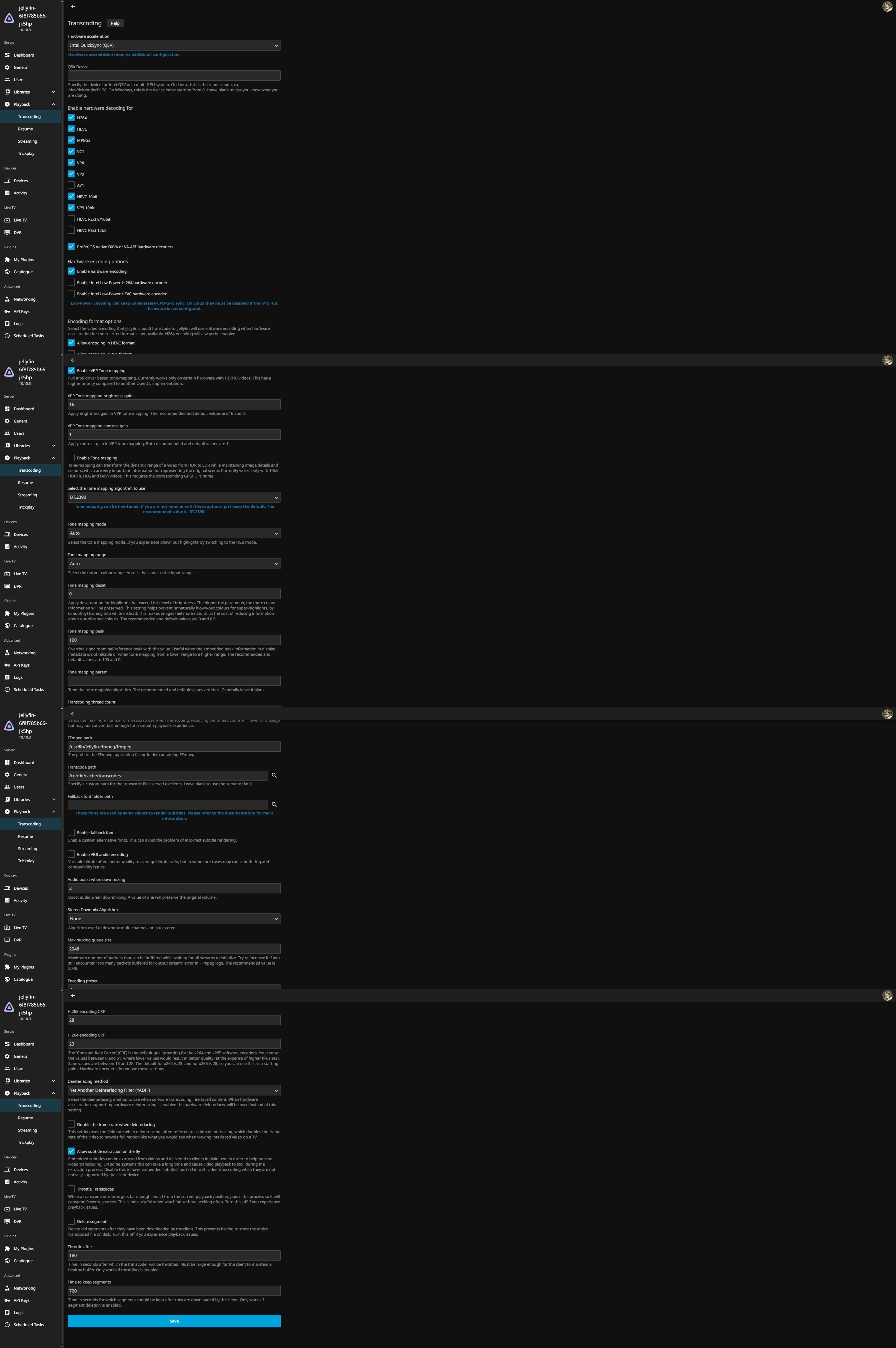

    Hey folks,
    I'm running into a playback issue on my Jellyfin server and could use a hand troubleshooting it.
    Issue Summary:
    Every time I try to play a video via the web UI, I get this:
    Playback Error: Playback failed due to a fatal player error.
    Looking at the logs, it seems FFmpeg is crashing with exit code 139.
    System Info:
    [*]CPU: Intel N100 (iGPU passthrough)
    [*]Running in K8 container
    [*]FFmpeg version: 7.0.2-Jellyfin
    [*]Hardware Accel: VAAPI + QSV
    Symptoms & Logs:
    Playback fails and server logs show:
    [ERR] FFmpeg exited with code 139 ... Transcode Reason: ContainerNotSupported, SecondaryAudioNotSupported, VideoRangeTypeNotSupported
    File info:
    Example Movie (2023) 4K HDR Bluray
    [list]
    [*]Video: HEVC Main 10, Dolby Vision P8.1 (HDR10)
    [*]Audio: Dolby TrueHD + Atmos (7.1), AC3, AAC
    [/list]
    VAAPI Diagnostics (inside container):
    vainfo
    Outputs:
    error: XDG_RUNTIME_DIR is invalid or not set in the environment. error: can't connect to X server! libva info: VA-API version 1.20.0 Driver: Intel iHD - 24.1.0 Supported profile and entrypoints: VAProfileNone : VAEntrypointVideoProc VAProfileNone : VAEntrypointStats
    Also tested:
    /usr/lib/jellyfin-ffmpeg/ffmpeg
    -init_hw_device vaapi=va:/dev/dri/renderD128
    -hwaccel vaapi -hwaccel_device va -hwaccel_output_format vaapi
    -i /data/movies/Example\ Movie\ 202320232023.mkv -f null -
    ^ This runs fine manually inside the container.
    FFmpeg Command from Jellyfin logs:
    /usr/lib/jellyfin-ffmpeg/ffmpeg -analyzeduration 200M -probesize 1G ... -init_hw_device vaapi=va:,vendor_id=0x8086,driver=iHD
    -init_hw_device qsv=qs@va -init_hw_device opencl=ocl@va
    -filter_hw_device qs -hwaccel vaapi -hwaccel_output_format vaapi ... -vf "...,tonemap_vaapi=...,hwmap=derive_device=qsv,format=qsv" ...
    This command fails and results in FFmpeg exit 139.
    Things I've Tried:
    • Confirmed GPU passthrough (/dev/dri/renderD12Nerd-face
    • Manual ffmpeg VAAPI decode test works
    • vainfo works despite the XDG_RUNTIME_DIR warning
    • Tried isolating filter chain in test ffmpeg calls (no crash)
