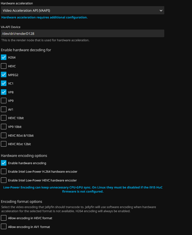

    Switch to VAAPI and try again. Check H264, VP8, VC1, and MPEG2.

    Also, try enabling this option and post a new log.
    Hardware encoding options
    Enable hardware encoding
    Make sure both of these are unticked. As you might only be able to encode in X264.
    Encoding format options
    Allow encoding in HEVC format
    Allow encoding in AV1 format

    just confirming my settings:
    Thank you!
