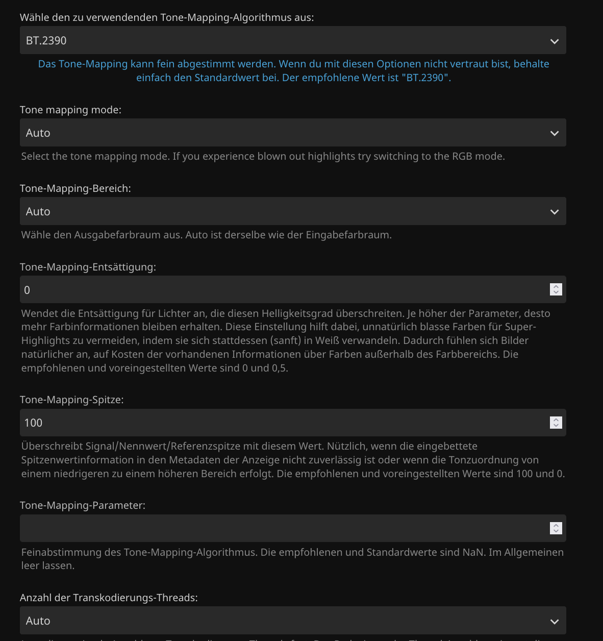

    Can you share how your transcoding settings look like within Jellyfin's dashboard?

    (2025-03-11, 08:45 PM)Efficient_Good_5784 Wrote: Can you share how your transcoding settings look like within Jellyfin's dashboard?
    Here we go...hope you don't mind that settings are in German....
