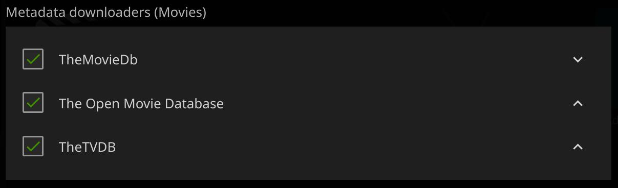

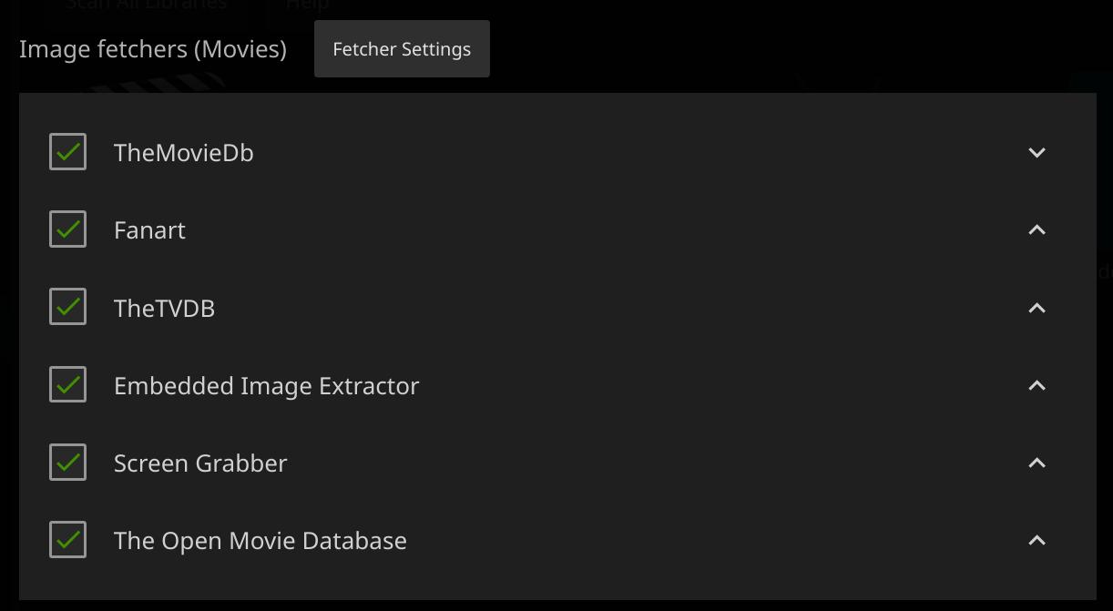

    Go to Dashboard > Libraries, select your movie library, and share screenshots of how you have all the metadata providers configured.

    2025-04-04, 07:29 PM
    (2025-04-04, 06:42 PM)TheDreadPirate Wrote: Go to Dashboard > Libraries, select your movie library, and share screenshots of how you have all the metadata providers configured.
    I don't think it's relevant but here...
    Reputation: 463
    2025-04-04, 07:56 PM
    I was thinking that if you had some whacky configuration for metadata providers, that could potentially break something. But the way things are ordered shouldn't be a problem.

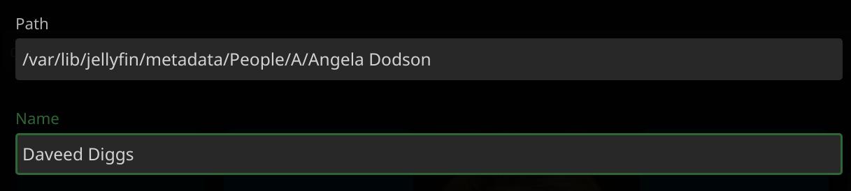

    Look at this attached screenshot.
    Angela Dodson directory path is correct.
    Metadata fills in for Daveed Diggs instead.
    Ain't it weird? I have no clue how these wires got crossed in the first place.
    I cannot think of a single explicable reason why this would have occurred between these 2 actors.
    A couple variables, perhaps relevant, perhaps not...
    Angela Dodson doesn't have a TVDB ID or entry
    Daveed Diggs has IDs and entries on both TMDB and TVDB.
    When I click on an actor profile to manually identify and type in "Daveed Diggs",
    only the clickable TVDB profile is fetched by Jellyfin, as it fails to fetch the clickable TMDB profile of Daveed Diggs.
