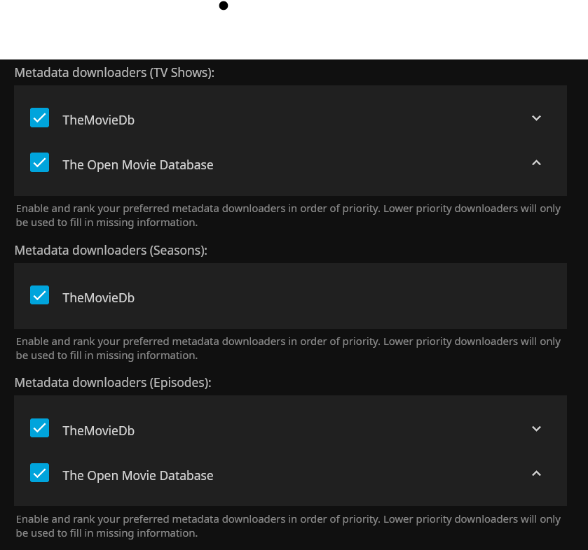

    2025-02-19, 08:51 PM
    Attached is a screenshot of my library's metadata setup, but I believe it's as you say it should be

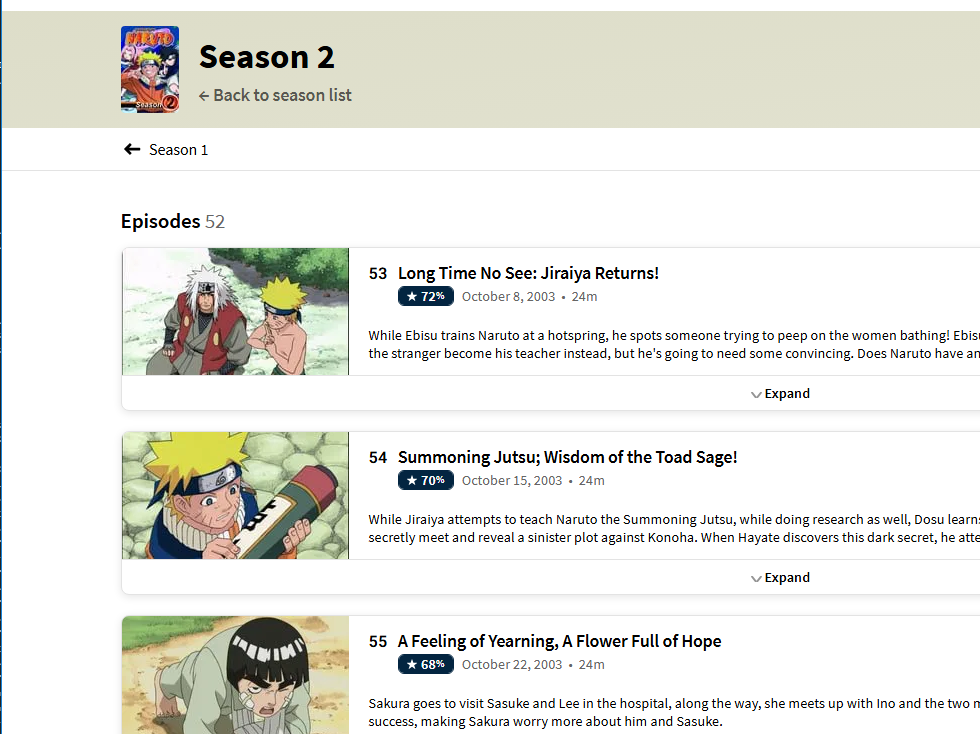

    2025-02-19, 09:10 PM
    You need to match their naming scheme: https://www.themoviedb.org/tv/46260/seas...uage=en-US
    First episode for season 2 starts at episode 53.
    -Naruto
    --Season 01
    --- Naruto - S01E01.mkv
    --- Naruto - S01E02.mkv
    --- Naruto - S01E52.mkv
    -- Season 02
    --- Naruto - S02E53.mkv
    --- Naruto - S02E54.mkv
    --- Naruto - S02E184.mkv
    2025-02-19, 09:16 PM (This post was last modified: 2025-02-20, 04:55 PM by TheDreadPirate. Edited 1 time in total.)
    It looks like some weeb decided that the episode numbers for the aired order use absolute numbers even though it also has a season number.
    There is a "corrected" aired order, but Jellyfin does not currently have a mechanism to select a different order of the same type.
    @theguymadmax beat me to it.
