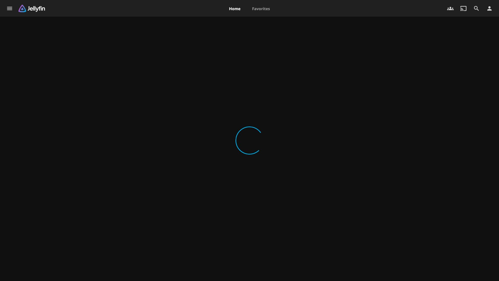

    My Jellyfin on Localhost won't display the Home Screen Library categories if the Internet is offline or Ethernet is disconnected. It just shows a spinning blue loading circle.
    I'm not streaming over the Internet or Network, I'm directly playing the file off a hard drive connected to the PC.
    I connect with the Web Browser or Jellyfin Media Player.
    This URL doesn't load the Home Screen categories when offline
    http://127.0.0.1:8096/web/#/home.html
    These URL's work, display the media thumbnails and files are playable offline
    http://127.0.0.1:8096/web/#/movies.html
    http://127.0.0.1:8096/web/#/music.html
    http://127.0.0.1:8096/web/#/list.html

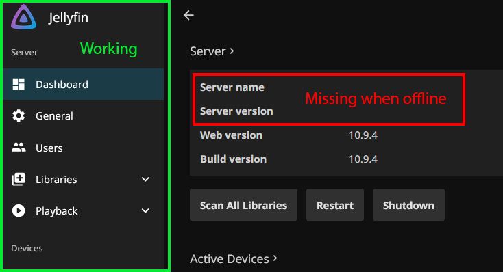

    Dashboard works and settings are savable offline
    http://127.0.0.1:8096/web/#/dashboard

    I tested this on 2 computers with Windows 11 and the Home Screen will not load on either, unless the Internet and Ethernet/WiFi are connected.
    The first computer:
    A fresh install of Server jellyfin_10.9.4_windows-x64 and JellyfinMediaPlayer-1.10.1-windows-x64.
    The second computer:
    I upgraded Server from jellyfin_10.8.12_windows-x64 to jellyfin_10.9.4_windows-x64.
    And I upgraded JellyfinMediaPlayer-1.9.1-windows-x64 to JellyfinMediaPlayer-1.10.1-windows-x64.
    It used to work on Server version 10.8.12 without being connected to a Modem/Router.

    The fact that the servername and version don't populate sounds like the networkmanager component of jellyfin somehow affects other components that should fetch info from library.db file. I don't know if this is by design or if you have found a bug. To me personally, it sounds like this should be a bug....

    Before I do that, I found a temporary fix.
    I've identified the problem is with the Player and not the Server.
    I uninstalled JellyfinMediaPlayer 1.10.1 and reinstalled the older 1.9.1, it now works. The Home Page Library categories now load while offline.
    I'm still using the latest Server 10.9.4.
    I'm guessing the problem is in the JavaScript files of the jellyfin_10.9.4_windows-x64 Server's Web Player and the JellyfinMediaPlayer-1.10.1-windows-x64 Desktop Player.
    There is something hardcoded that is blocking loading the Libaries if the Network is offline.
