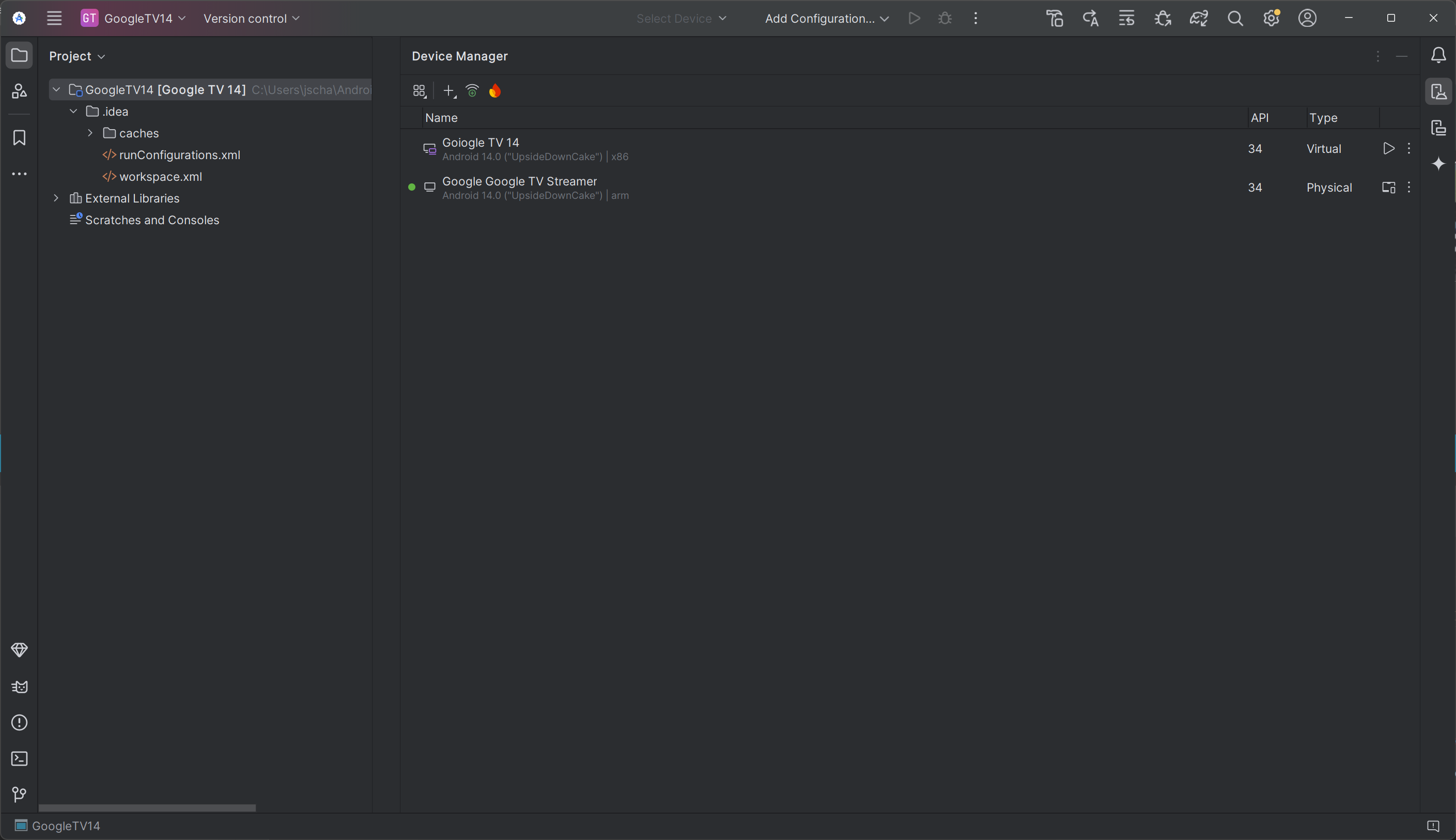

    @M0RPH3US, not sure if you are able to install Android Studio, but if you can it comes with a whole virtual machine environment for running Android operating systems for testing.
    I'm still more than happy to help if you prefer to do the scripting and coding blind, but I figured it might be easier for you if you could see it for yourself live, as you make the tweaks.
    Some screenshots from my Google TV 14 virtual machine instance. The screenshot showing Jellyfin with the media bar displayed is a sideloaded Jellyfin for Android 2.6.2 apk (the version on the Play Store) in the Android TV virtual machine.

    (2025-02-19, 10:35 PM)Jamie Chapman Wrote: @M0RPH3US, not sure if you are able to install Android Studio, but if you can it comes with a whole virtual machine environment for running Android operating systems for testing.
    Added initial Landscape support. Check out the fullscreen css, as of now update only pushed for the fullscreen.
    Though this was blind, but I will try out android studio going forward. Thanks for the info.

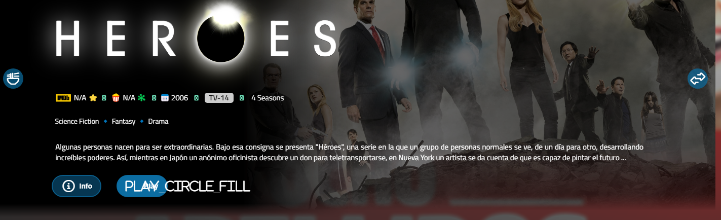

    hey!! I tested the last version and now I have a bug with "play" button.
    Anyone with the same bug?
    Also, tested for the first time fullscreen and the top doesn't cover, dunno why...
    EDIT: The play button bug was for the zombie theme, changed for now.
    EDIT2: Tested the zesty theme and everything is working, but still a bit of top without being filled

    (2025-02-20, 12:28 AM)Rubén Navarro López Wrote: hey!! I tested the last version and now I have a bug with "play" button.
    You are using an old version of zombie. Try this.
    @import url(https://cdn.jsdelivr.net/gh/MakD/zombie-release@main/pre-release/wip.css);
