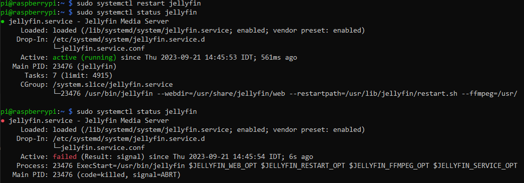

    jellyfin service failed (core=killed, signal=abrt).
    i use raspberry pi 4 with raspbian GNU/ linux 10 (buster).
    after my plex service suddenly stopped working (after a year of working fine) for the same reason i tried using jellyfin and it worked for an hour.
    after an hour i rebooted the pi and couldnt get to the web gui, so i checked and the service failed with the follwing prompt in systemctl:
    pi@raspberrypi:~ $ sudo systemctl status jellyfin
    ● jellyfin.service - Jellyfin Media Server
        Loaded: loaded (/lib/systemd/system/jellyfin.service; enabled; vendor preset: enabled)
        Drop-In: /etc/systemd/system/jellyfin.service.d
                └─jellyfin.service.conf
        Active: failed (Result: signal) since Thu 2023-09-21 00:19:34 IDT; 9h ago
      Main PID: 2750 (code=killed, signal=ABRT)
    pi@raspberrypi:~ $ sudo systemctl start jellyfin
        Active: failed (Result: signal) since Thu 2023-09-21 09:54:57 IDT; 11s ago
        Process: 16120 ExecStart=/usr/bin/jellyfin $JELLYFIN_WEB_OPT $JELLYFIN_RESTART_OPT $JELLYFIN_FFMPEG_OPT $JELLYFIN_SE
      Main PID: 16120 (code=killed, signal=ABRT)
    EDIT: if it helps after service restart its running for few ms and then fails again
    i am lost, help please.
    thanks in advance.

    I would check the logs. /var/log/jellyfin/log_<date>.log

    I have no file related to jellyfin in /var/log/
    2023-09-21, 12:25 PM (This post was last modified: 2023-09-21, 12:30 PM by TheDreadPirate. Edited 1 time in total.)
    There should be a jellyfin folder in /var/log/. How did you install Jellyfin?
    Also run this command.
    journalctl -xeu jellyfin

    this is what i got from running the command:
    Defined-By: systemd
    Support: https://www.debian.org/support
    Automatic restarting of the unit jellyfin.service has been scheduled, as the result for
    the configured Restart= setting for the unit.
    21 15:06:41 raspberrypi systemd[1]: Stopped Jellyfin Media Server.
    Subject: A stop job for unit jellyfin.service has finished
    Defined-By: systemd
    A stop job for unit jellyfin.service has finished.
    The job identifier is 8888 and the job result is done.
    21 15:06:41 raspberrypi systemd[1]: jellyfin.service: Start request repeated too quickly.
    21 15:06:41 raspberrypi systemd[1]: jellyfin.service: Failed with result 'signal'.
    Subject: Unit failed
    Defined-By: systemd
    The unit jellyfin.service has entered the 'failed' state with result 'signal'.
    21 15:06:41 raspberrypi systemd[1]: Failed to start Jellyfin Media Server.
    Subject: A start job for unit jellyfin.service has failed
    Defined-By: systemd
    A start job for unit jellyfin.service has finished with a failure.
    The job identifier is 8888 and the job result is failed.
    -i have no folder of jellyfin in /var/log/.
    -i installed it in my raspbian pi 4 with this guide: https://pimylifeup.com/raspberry-pi-jellyfin/

    In the curl command i get:
    "Sorry we dont support the debian codename '' with this script,please consider a docker based or manual install instead"

    2023-09-22, 05:43 AM
    Reinstalling doesnt seem to work either, i get the same problem from the start.
