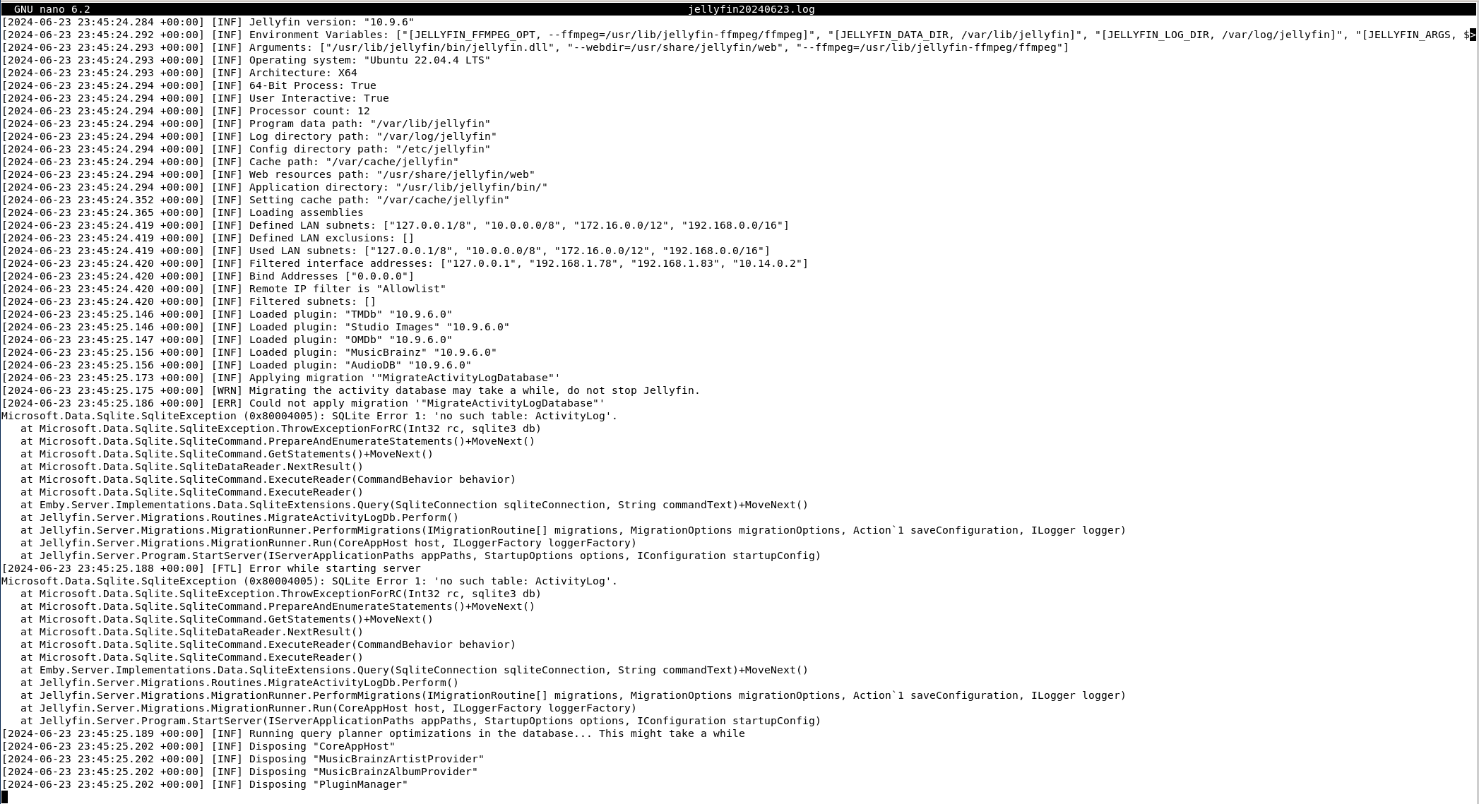

    Jelllyfin erroring at migration of ActivityLog (I think?)
    Chris Kudla
    2024-06-24, 12:08 AM (This post was last modified: 2024-06-24, 01:37 AM by Chris Kudla. Edited 1 time in total.)
    Jellyfin Version: 10.9.6
    Jellyfin Install Method: Linux Ubuntu
    Expected: Startup complete, running / active
    Actual: Upon startup, jellyfin tries to start, but then shuts down and becomes inactive / dead
    Logs attached
    I did try the solution suggested in this thread with a similar issue "deleting the config and cache directories" and then restarting. This did not fix the issue
    If there is anything else I can provide, please let me know

    You say that you are using docker, but all the paths in the thumbnail are for a package install (apt).

    (2024-06-24, 01:00 AM)TheDreadPirate Wrote: You say that you are using docker, but all the paths in the thumbnail are for a package install (apt).
    Apologies, removed. Have docker, thought I might have been using it - that is not the case based on your reply.

    Can you delete /etc/jellyfin/migrations.xml and try restarting the service?

    Just tried - it did recreate the file, but it didn't work for the service as it got stuck at the same spot.
    The file it created did create it in jellyfin:jellyfin rather than jellyfin:root as the other files are. The file created has 1030 (assuming that's mbs?) so it's not empty.

    Stop Jellyfin then rename all the files in /etc/jellyfin (just add .orig to the file name). Then start jellyfin. If it still fails, share a fresh jellyfin log via pastebin.

    Changing the file names to .orig worked. Here is the pastebin log from jellyfin - https://pastebin.com/MQ0ed3QU .
    Is there anything else I need to do (e.g., delete the now defunct .orig files) to make sure everything is working as intended now?
    Thank you so much for your help btw! I really appreciate it!

    If everything is working now, you can get rid of them. But the log looks good now.
