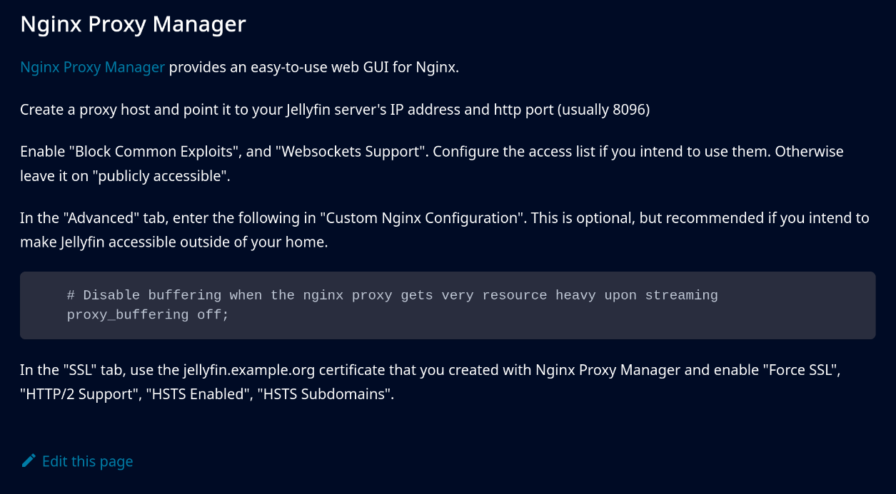

    I checked the wiki at -> https://jellyfin.org/docs/general/post-i...oxy/nginx/

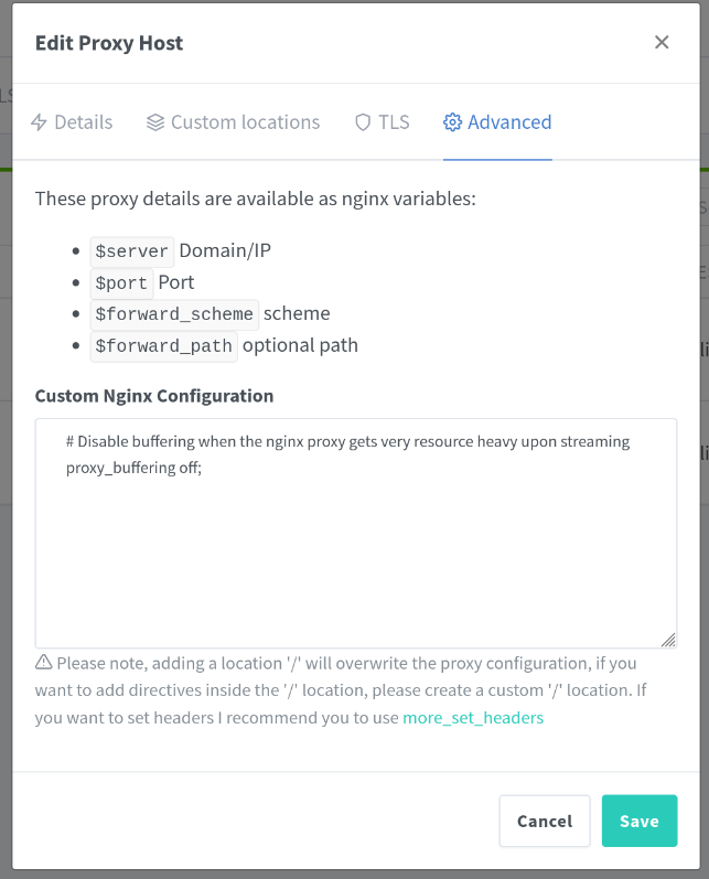

    and added the
        # Disable buffering when the nginx proxy gets very resource heavy upon streaming
        proxy_buffering off;
    But i that doesn't solve the issue, just for clarity i don't have to do the above steps right?
    because the forward config will be automatically generated when making the forward with the GUI of Nginx?

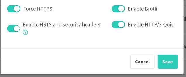

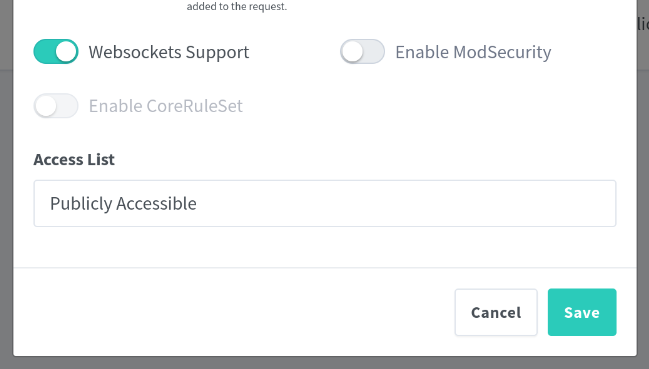

    On the nginx side, I'm more familiar with vanilla nginx and SWAG than NPM, but can you share what your config looks like?

    I was referring to the steps in the link, As in the screenshot.
    My nginx setup is as seen in the screenshots.
