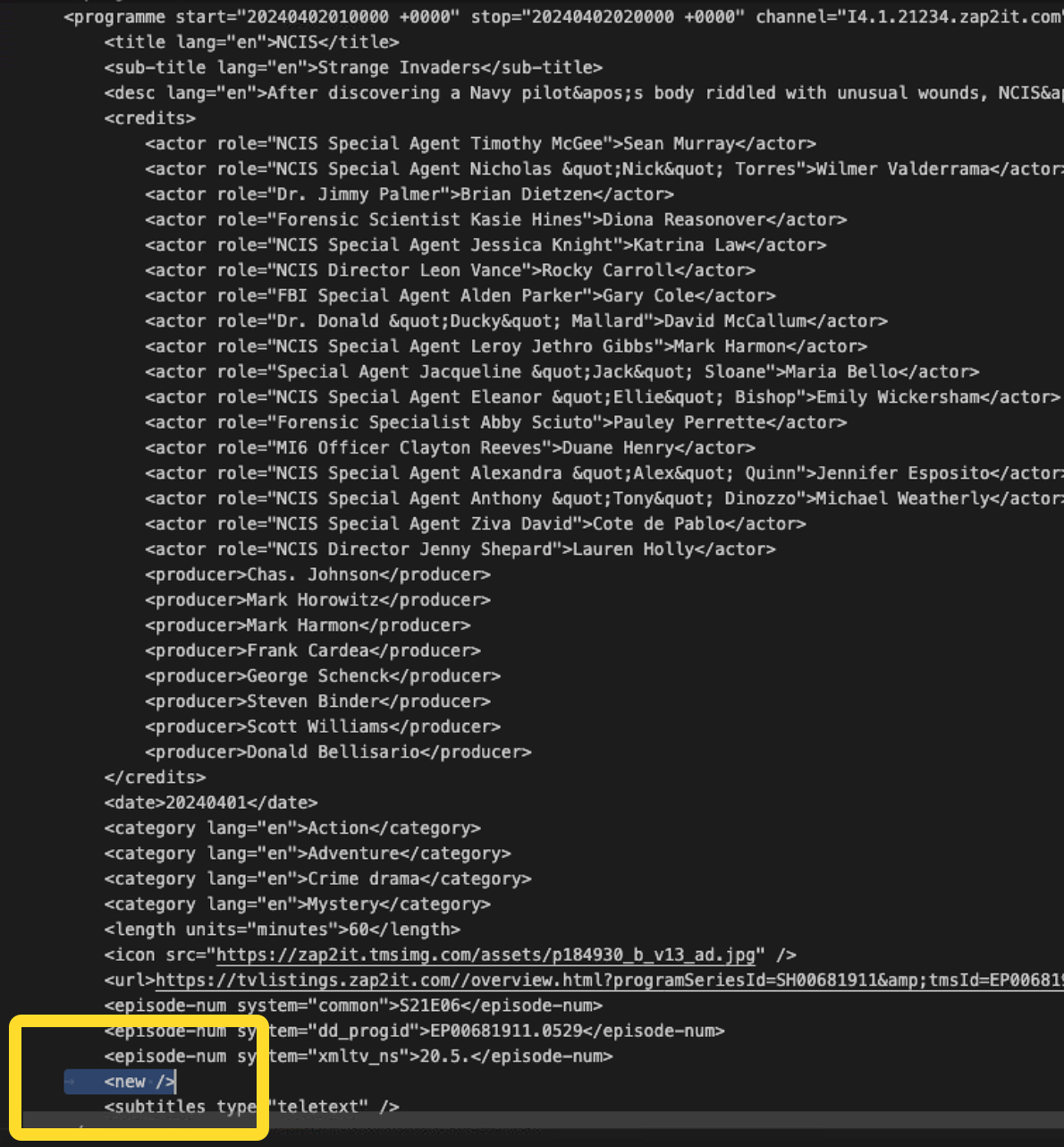

    Hello! I have a few questions about Live TV, in particular what logic is used to determine a 'New' episode to record.
    NCIS has a new episode tonight, but if I set it to record new episodes only, it has the greyed out double dot indicating that it won't record.
    In the guide, it says "New", so I'd think it should record?
    The checkbox for "don't record if it's already in my library" is also unchecked (and this is a new episode, so it should record anyways?)
    The "New" doesn't show up in the iOS Jellyfin app, maybe this is just a platform bug?
    In my XML TV guide data, there is also the <new /> tag for this specific episode, so Jellyfin should know that this is a new episode.
    I am running JF v10.8.13 on macOS monterey.
    To get my guide data xml, I am using zap2xml on docker
    I tried to search the forums, saw a couple threads but it says "the specified thread does not exist."
    Thank you for your help!!

    This is happening with other shows as well, Survivor airs new episodes, if it's set to "New episodes only", it does not record them, even though they are new

    Can you share your jellyfin logs with us via https://sourceb.in/
