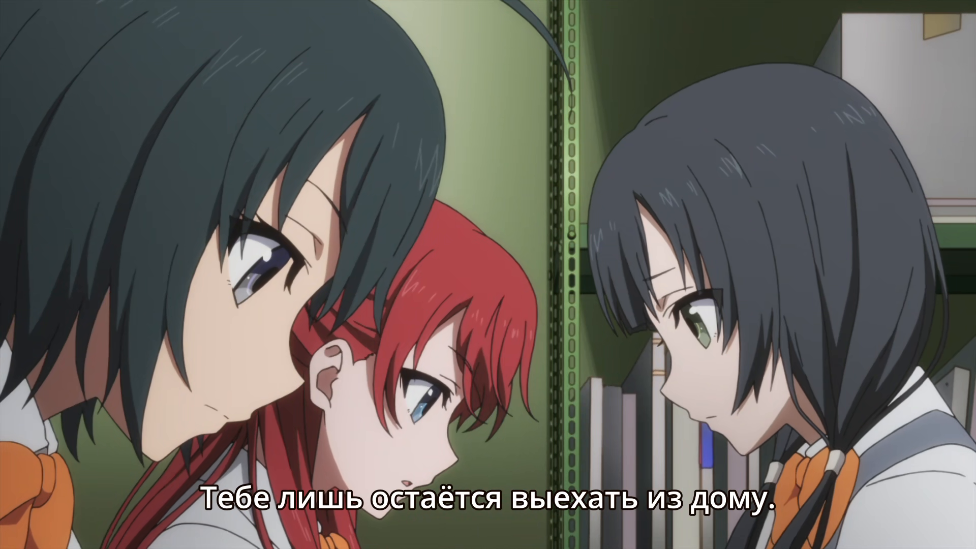

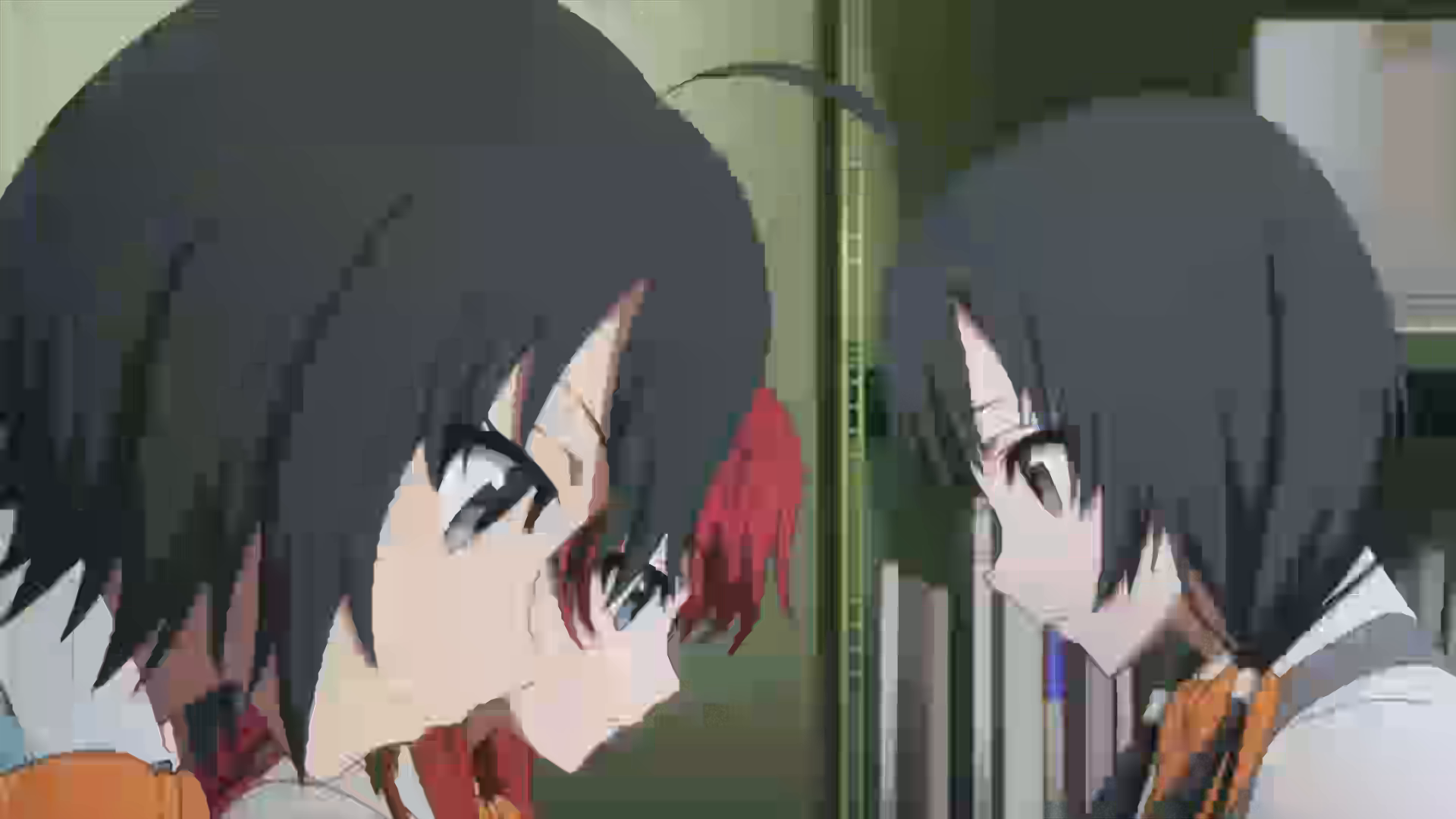

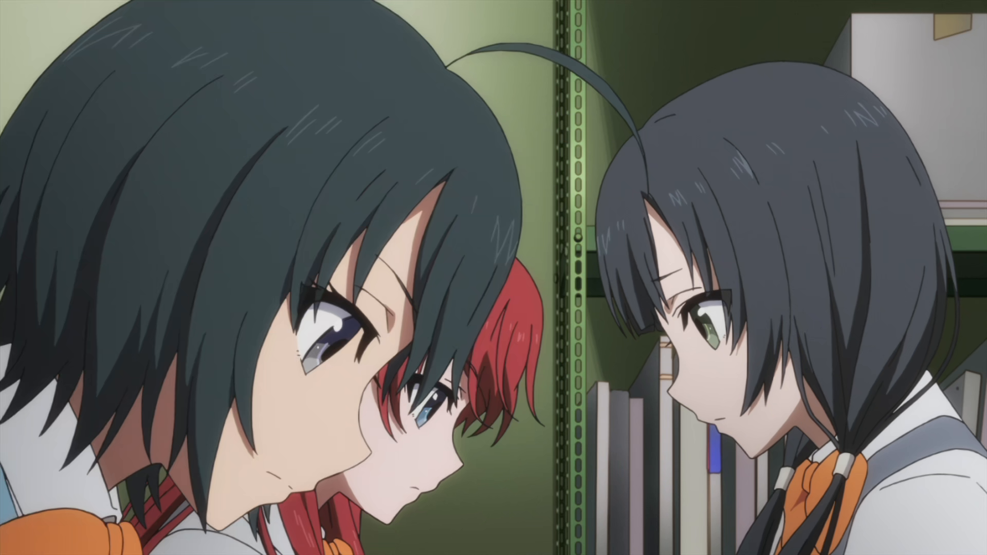

    Most of the time the picture quality is good, but sometimes there are low quality frames.
    Rare
    Most of the time

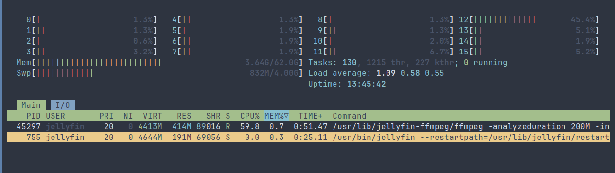

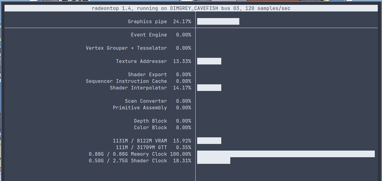

    It doesn't look like I'm running out of resources for transcoding, the system is almost idle

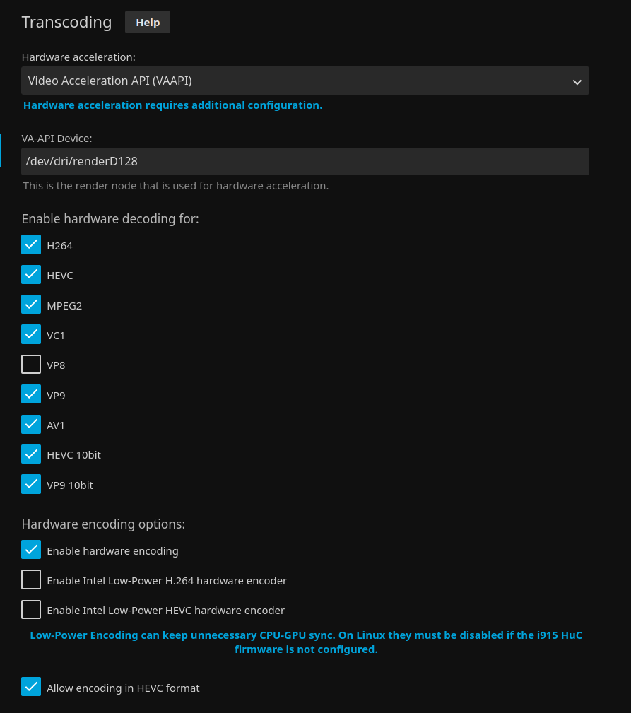

    Transcoding settings
