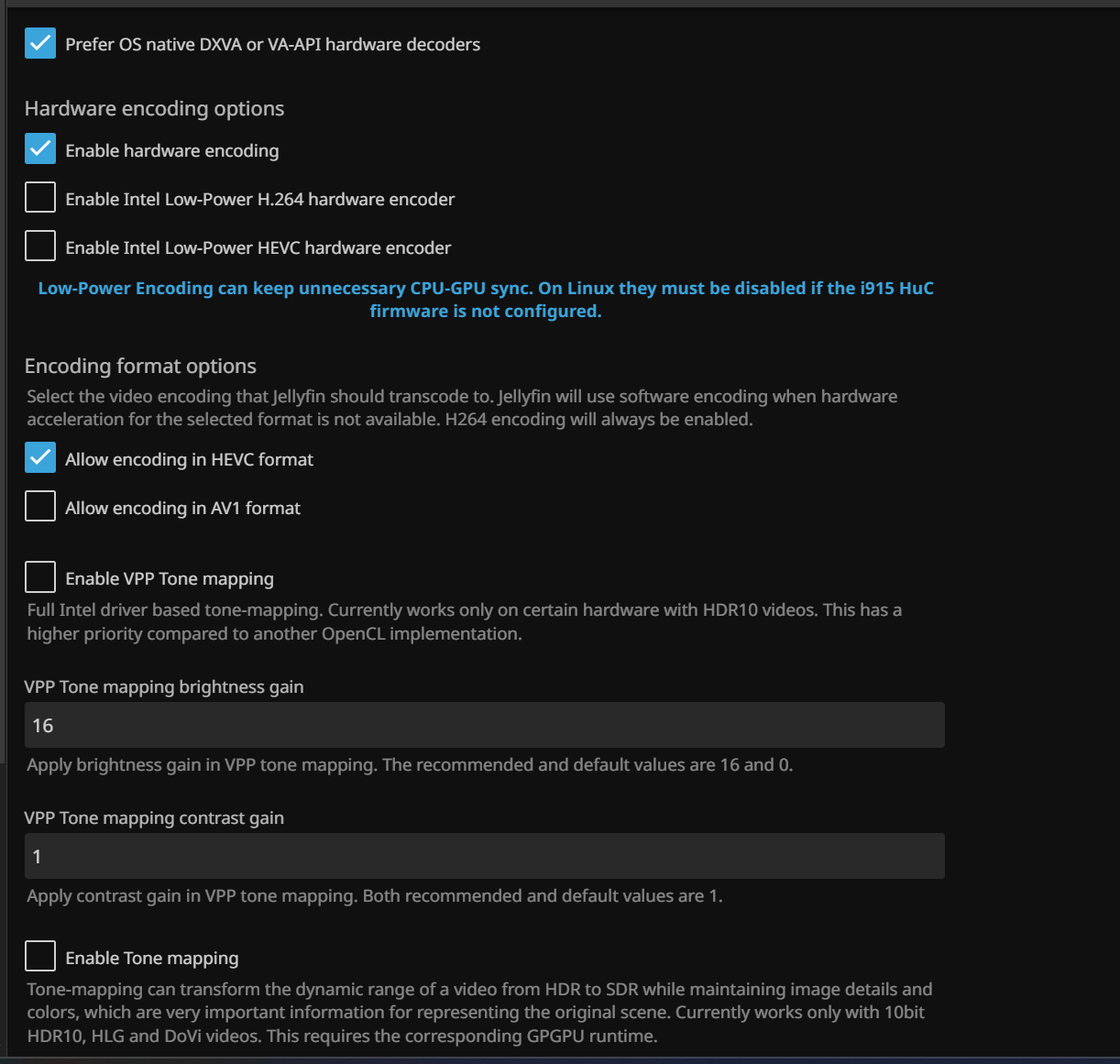

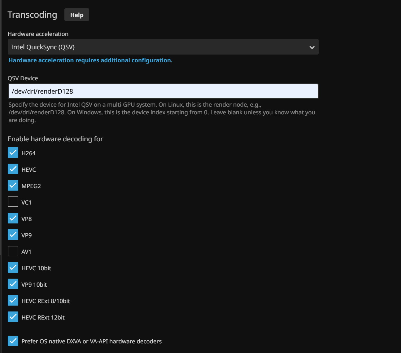

    recently migrated to a new n100 box.. this time trying to use ubuntu. got everything set up properly but i think im having transcoding issues.
    videos start to play and then freeze and buffer.
    i went through the qsv steps https://jellyfin.org/docs/general/admini...tion/intel and have everything configured.

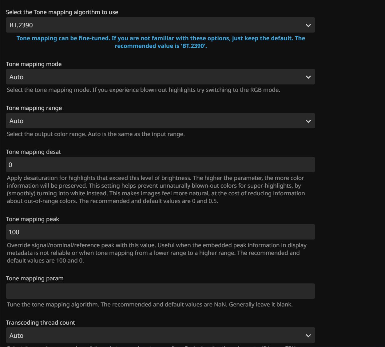

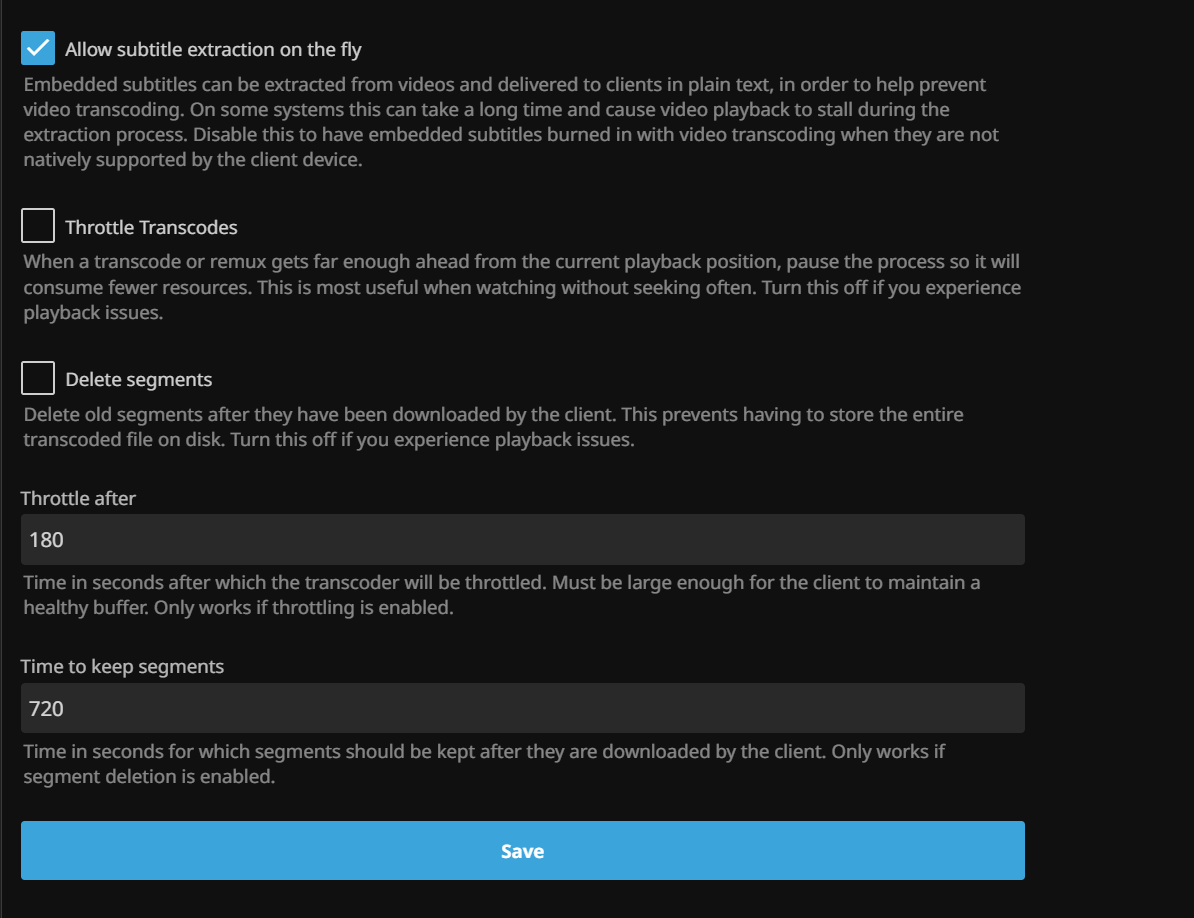

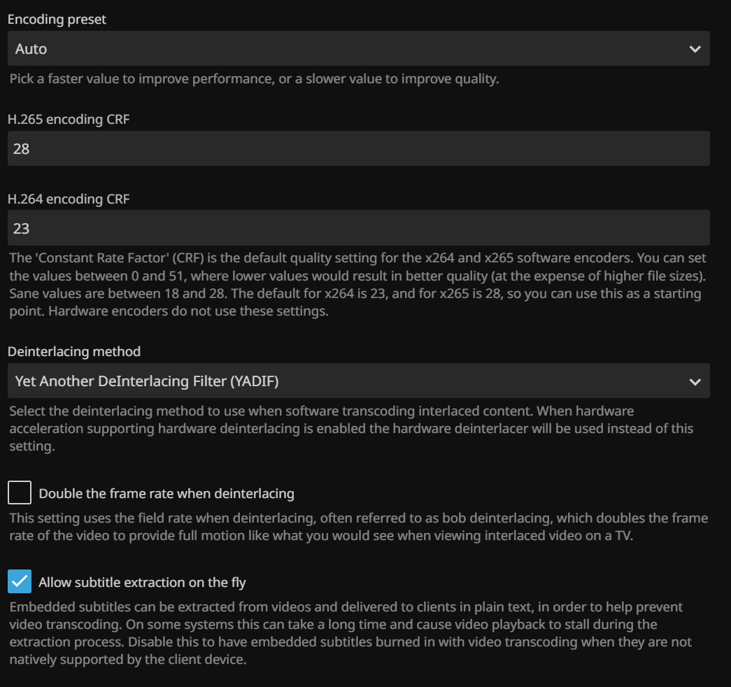

    Also could you screenshot the rest of the transcoding page? I think it's be correct so far just to be sure....
