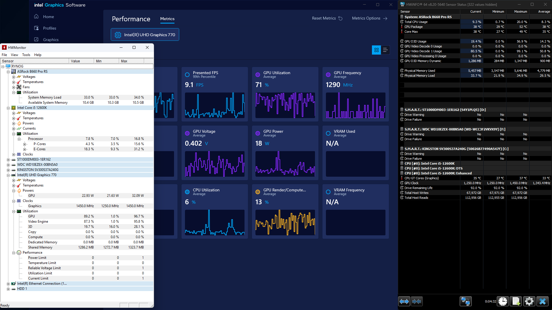

    Hello. I'm pretty new to the world of Jellyfin. I was hoping to set up a media server running off an i5-12600k filled with 4k movies that I could stream to various devices, assuming that it would be able to handle transcoding multiple (6+) streams simultaneously as long as I avoided trying to play HDR on SDR screens.
    After selecting QSV in the hardware acceleration field and enabling hardware decoding/encoding I'm finding that most HEVC media streamed to my phone (Motorola G Power 2022 which I don't believe supports HEVC) has awful pausing and dropped frames unless I manually set the bitrate. I have no idea why playback isn't smoother; my network speed is sufficient, I can see the video is transcoding and none of my CPU, iGPU and RAM are maxed out (though Intel software does seem to indicate way more gpu usage that I would expect from a single transcode.) As long as I select the next bitrate down from it's native value the stream is ok, but if I just leave it on auto I have choppy playback on most HEVC media above 1080p/6Mbps.
    I tried derping around with ChatGPT and it said that despite the transcoding process the bitrate is too high for the target device, which kinda checks out since I don't have any of these issues streaming the same or higher quality media to my gaming PC. However a 4k HEVC video at ~21Mbps requires manual adjustment down to 20Mbps to be smooth, whereas a 1080p HEVC at 6.5Mbps may or may not require changing to 6Mbps, and a lower bitrate around 1.5 plays fine without adjustment.. . BUT shouldn't part of the transcoding process involve detemining an acceptable bitrate for the client device? Why would a 4k source video play fine at "20Mbps" while a 1080p can't handle 8 on auto?
    It's very confusing to me and some of my friends and family are even less tech-savvy than me so I'd love a solution that doesn't require any manual bitrate adjustments etc to be done by them (and honestly it would be great to build a library in HEVC for better quality/space considerations. It's getting tough to find new releases in 264.)
    I've attached a pic of my Playback settings in case that helps (or at least provides a chuckle) as well as some system information captures while trying to playback 4K HEVC media to my phone (~350 dropped frames in short order)

    The transcode logs look fine. Transcoding plenty fast.
    From what I can find for your phone, the hardware decoders on it are lacking. 1080P30 for HEVC. Same with H264. 1080P30. So 4K is going to need to be transcoded. What is likely happening is that the phone is not accurately reporting its capabilities and isn't triggering a transcode when it should be.
    But the Android app has settings to set the maximum allowed resolution.
    Settings > Playback > under the Video Quality section check "Limit maximum supported video resolution" and set the drop down above it to 1080P.
    If your friends and family have more capable phones, this won't be a concern.
