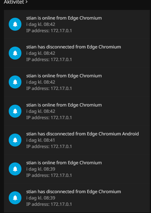

    I'm having some issues with IPs on my server... Jellyfin is being run behinde nginx proxy manager. It only gives me 172.17.0.1 for IPs, regardless where I connect from...
    NPM and Jellyfin is both running inside a docker container.
    I have a DNS server running as well (Adguardhome in docker) that I've set for my network, I'm as well redirecting jf.mydomain.no to 10.0.0.140 inside adguardhome.
    I've attached som photos from jellyfin and NPM.
    NPM advanced tab contains the Jellyfin nginx config from their DOC.
    Anyone know what to do?

    I use vanilla nginx, so my config is a bit different, but if you read the note on the last screenshot you included, it says that set_header and add_header directives are ignored and must be added in a location custom config.
    I would guess that's where your issue is -- your set_header directives are not part of a location block and are being ignored.

    (2024-05-28, 12:31 PM)bitmap Wrote: I use vanilla nginx, so my config is a bit different, but if you read the note on the last screenshot you included, it says that set_header and add_header directives are ignored and must be added in a location custom config.
    Yea I did notice that... But the in the docs it says to put it there... So I'm not sure ( https://jellyfin.org/docs/general/networ...xy-manager )
    I tried to create custom location and so on.. But then it stops working all togehter.....

    Yes, I put the IP for it in there( 10.0.0.140 ). Because the NPM and DNS is also running on the same host as jellyfin.
    2024-05-28, 01:26 PM
    Is 172.17.0.1 the IP of the Nginx container? If so, that should be IP for the known proxy.

    (2024-05-28, 01:26 PM)TheDreadPirate Wrote: Is 172.17.0.1 the IP of the Nginx container?  If so, that should be IP for the known proxy.
    Npm has: 172.18.0.2.
    I think 172.17.0.1 is the gateway? Or am I wrong.
    2024-05-28, 01:58 PM
    Try either of those. Pretty sure it should be Nginx's IP, 172.18.0.2.

    (2024-05-28, 01:58 PM)TheDreadPirate Wrote: Try either of those.  Pretty sure it should be Nginx's IP, 172.18.0.2.
    I tried putting it as know proxy, didn't do anything.
    I restarted afterwards. hmmm
