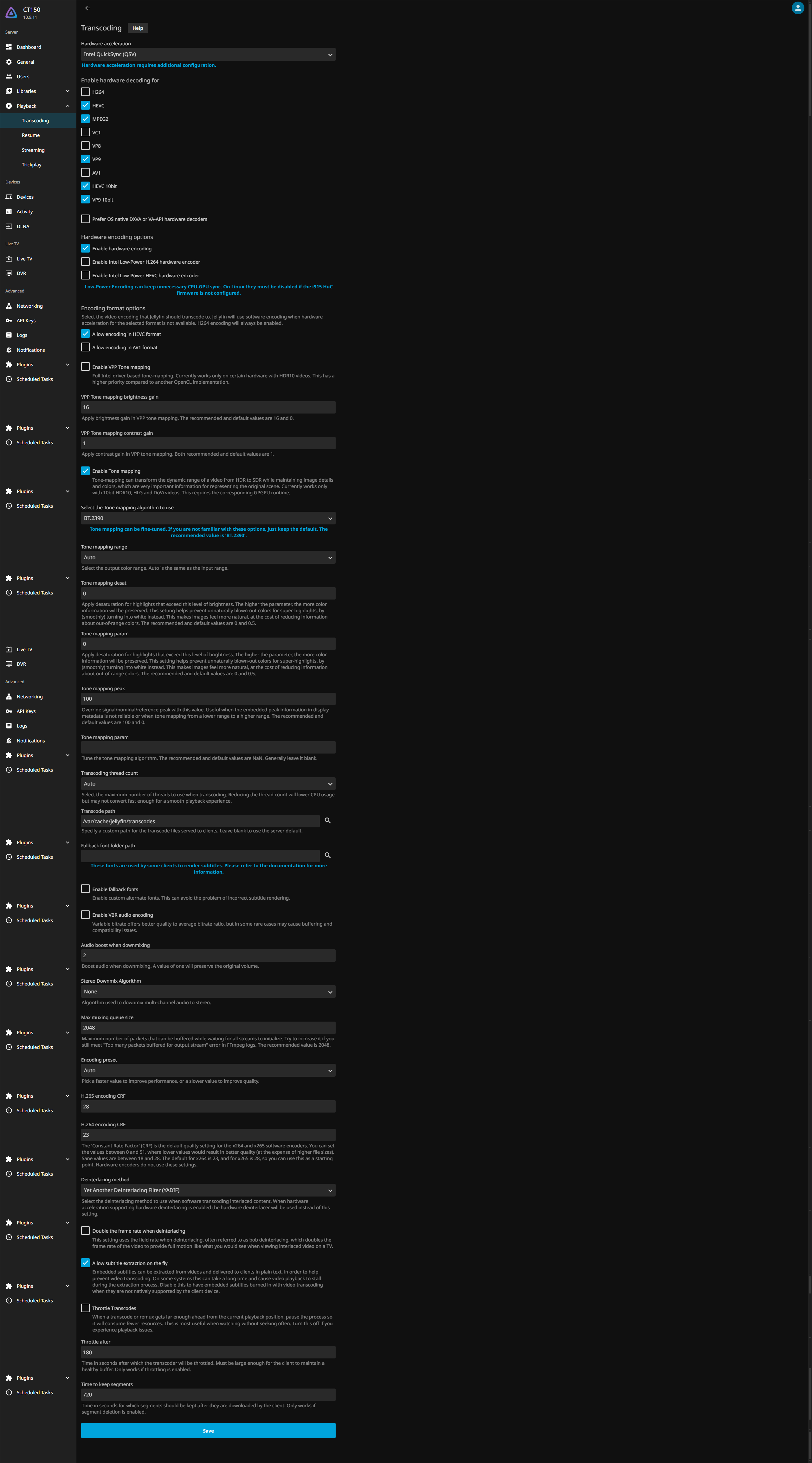

    2024-09-15, 01:30 AM
    Can you share screenshots of Dashboard > Playback? And the media info for the video you are having issues with.
    Jelly_
    Posts: 8
    2024-09-18, 08:40 PM (This post was last modified: 2024-09-18, 08:43 PM by Jelly_. Edited 1 time in total.)
    (2024-09-15, 01:30 AM)TheDreadPirate Wrote: Can you share screenshots of Dashboard > Playback?  And the media info for the video you are having issues with.
    Attached is the screenshot. I'm not able to play any kind of video.
    (2024-09-14, 01:22 AM)Playing4Peanuts Wrote: What codec is the video you are trying to transcode? I was having this problem trying to hardware transcode MPEG2 SD videos and VC-1 videos because my 12 series intel I5 didn't have the codecs to hardware transcode those.
    I unchecked those and they started playing fine. Make sure all the codecs you have checked can actually be hardware transcoded by your CPU.
    I have added the screenshot of my playback settings. Let me know if you think I need to uncheck or add anything.
