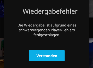

    The player doesn't work because jellyfin uses the wrong video stream

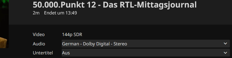

    The Video Codec that Jellyfin shows is 144p SDR but that ist the wrong Videocodec of the *.ts files as is has also a stream with the video codec MPEG2VIDEO. In my opinion, using the wrong video codec is what causes the Jellyfin player to crash.

    What is shown is the Title field of the video, not the codec. Some encoders will include or append the title with the codec and resolution, but not always.

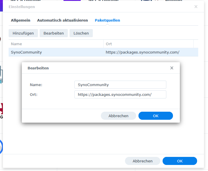

    Yes, I didn't install it in docker but via the SynoCommunity via  https://packages.synocommunity.com/ . The installation is very easy. The installation also requires ffmpeg 7 (current version 7.0.2-1) and SynoCli Videodrivers (current version 1.2.2), which is then immediately required when installing Jellyfin.
