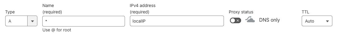

    In Cloudflare, under DNS/Records I registered a DNS for the Wildcard domain, like this.
    This saves me from having to register DNS for each subdomain I want to use.

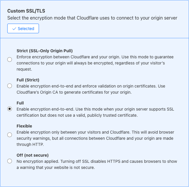

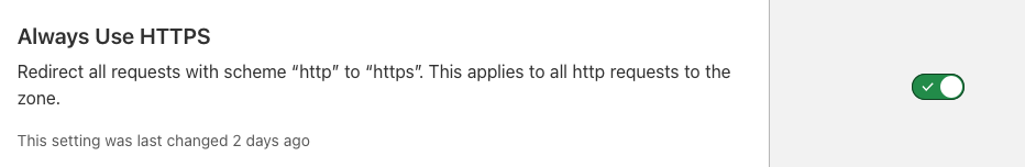

    For the encryption mode I have it set to Full and in Always use HTTPS.
    With this configuration I got a brand new URL with my domain, with certificates and I can access Jellyfin from my local network with this URL and https.

    Another thing that may be wrong is the IP in Cloudflare's DNS/Records tab.
    If you remember, in it I put the Local IP.
    However, I don't know which IP I have to put here. In the tutorials that I have followed, I am understanding that to open it to the internet, I would have to put my Public IP.
    The issue is that if I do this (along with Port Forwarding), not only do I still not have remote access, but I lose access to Jellyfin from my local network with the URL.

    Regarding #2, the IP you put in cloudflare is your PUBLIC IP, which you can find with sites like https://whatismyipaddress.com/ or just by finding your WAN IP in your router's settings.

    About this, when I tried to put under DNS/Records in Cloudflare my Public IP, stops working and I lose the local connection to jellyfin with the URL (I do get a message in the browser that I do not know very well what it means, which translating it from Spanish to English says something like this: this page is loaded from another page).
    At first I thought it could be because of Proton (for example, when I clicked on the link you gave me, what appeared, logically, was the IP that Proton gives me, and not my Public IP), but it doesn't seem to be the case.
    In the WAN options in my router, there are two IPs, one that I think is my Public IP, which says Internet, and that is the one that shows me the web page that you passed or the one that Proton shows me when it is not connected, and another one that I imagine will be the router's one, right?
    So, if in the Cloudflare registry I put the Local IP of my server, everything works perfectly (locally), but if I put the Public IP, sometimes it works for a few minutes but then stops working and does not work again until I change it to the Local IP.
    Why does this happen? Am I doing something wrong?

    Putting your LAN IP in Cloudflare will break access when not at home. Since those are private, non-routable, IPs.
    What you should be is put back your public IP in cloudflare. Then in your router you can do one of two things. You can enable NAT loopback/hairpin or you can create custom DNS entries. NAT hairpin/loopback tells your router to intelligently keep traffic local. If it queries your domain name and sees that the IP address is itself, it will keep local traffic local.
    The custom DNS entries would tell your local clients to use your LAN IP for your domain. But when your device disconnects, like your phone, the DNS results for your domain will now be your public IP.
    I personally prefer custom DNS entries since it will continue to work properly when there is an Internet outage.

    With your local IP in Cloudflare, remote access will definitely never work.
    With your PUBLIC address in Cloudfare, NAT loopback will cause requests to your domain to route to your server LAN IP. For NAT loopback to work you need port forwarding properly setup as well. That is assuming your router behaves the same as mine.

    Yeah, sorry, I meant to say PUBLIC IP instead of LOCAL. My mistake.
    So, to recap, having the Public IP and NAT Loopback, what I need is proper port forwarding. What I meant to say earlier was that I had at some point the Public IP in Cloulflare, the NAT Loopback and the ports open, but I didn't have local or remote connection. So I probably screwed up the port configuration.

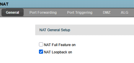

    To add more information before moving on to the port forwarding configuration, in the WAN section there is a table called GPON Connection Table. In it you can see an entry that is Internet with its IP (my Public IP) and another entry that says Voip_ip_interface, which I think is the router, with another different IP.
    If I edit the Internet entry, I have seen these NAT options:
    Is this correct?

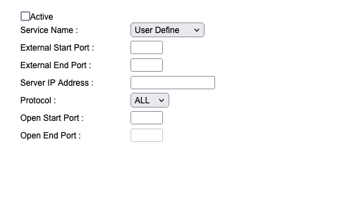

    (2025-04-01, 10:24 PM)TheDreadPirate Wrote: Can you share screenshots of your port forwarding config?
    In that screenshot they are not active.
    One column's missing in the above screenshot:
    In this column, in both rows, it is put the server's Local IP.
    When you add new rules, there is other option that doesn't show up in the above table, which is Protocol. In that option I set in both TCP/UDP.
    That is my full port forwarding configuration. Do you see something off?

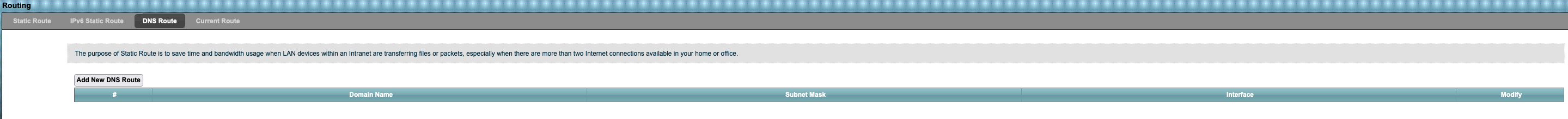

    (2025-04-01, 10:24 PM)TheDreadPirate Wrote: But, as I stated, custom DNS entries are the way to go.  If that is even an option.  On all the routers I've used, in the DNS config section of the router there was a "edit hosts" button or table where I could add DNS entries to.
    I have gone into all the router options and the only one that says something unique to DNS and that you can add entries is this option:
    Is this what you mean? If so, what exactly do I have to put in each column?

    SUA is the correct mode for NAT.
    From the info you provided, your port forwarding and Cloudflare setup are correctly. The only thing that would prevent it from working is if your ISP uses CGNAT (carrier grade NAT). Similar to how consume level NAT works, 1 public IP for multiple devices, some ISPs do the same at the ISP level. CGNAT pretty much makes it impossible to host a service since your IP changes pretty frequently and the carrier blocks unsolicited incoming requests like your router would if you don't setup port forwarding.

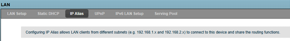

    In LAN Options, can you show me "IP Alias"?
    Or you can provide me with your router model and maybe I can find a manual for that model.

    (2025-04-02, 02:17 PM)TheDreadPirate Wrote: In LAN Options, can you show me "IP Alias"?
    Yeah, sure. Here it goes:
    These are the options:
    And this is what IP Alias row has:
    The other two options had IP addresses that I don't know if I should share. They are disable anyway.
