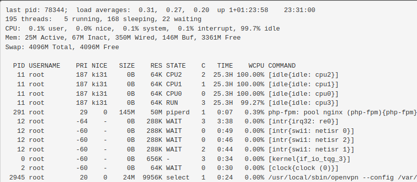

    Attached screenshot not much cpu usage while streaming

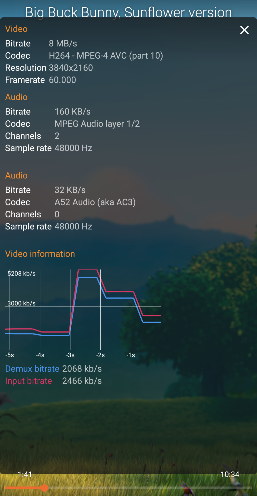

    brun2025
    Joined: 2025 Apr
    2025-04-24, 01:28 AM
    Unfortunately, streaming remote via Android app not working. However, I am able to stream h265 to a newer smart tv via the VLC app. Not ideal but I will try wireguard next
