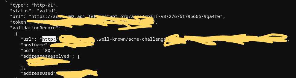

    Posts: 11,857
    2023-11-22, 02:17 AM (This post was last modified: 2023-11-22, 02:18 AM by TheDreadPirate. Edited 1 time in total.)
    A small portion of the process is http.  Has to be port 80.
