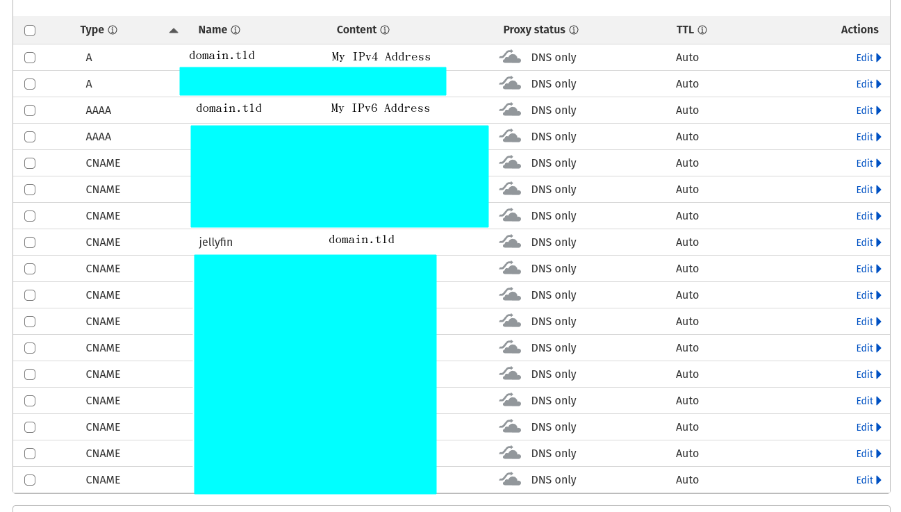

    2024-09-28, 07:12 PM
    You can have separate subdomains in cloudflare with different settings for each subdomain.
    You'd have an A and/or AAAA record that point to your domain and public IP. Then a bunch of cnames for each subdomain that point to your domain.

    2024-09-28, 07:55 PM (This post was last modified: 2024-09-28, 08:28 PM by 4r5hw45twh. Edited 8 times in total.)
    (2024-09-28, 07:12 PM)TheDreadPirate Wrote: You can have separate subdomains in cloudflare with different settings for each subdomain.
    "...that point to your domain." Do you mean from my domain? Like, an A record from my subdomain that points to my public home IP?
    On CloudFlare, I setup a tunnel for JF and it auto-added the subdomain I picked for it as a CNAME. My 2 A records currently are: "mydomain.com" and "www" and those hostnames are pointed to my domain registrar's DNS IP (I saw the URL they were set to on my domain host before activating CloudFlare with it and then used Dig to get the actual ipv4 of those). All 3 show as Proxied.

    2024-09-29, 12:04 AM (This post was last modified: 2024-09-29, 12:06 AM by TheDreadPirate. Edited 2 times in total.)
    Negatory.  Subdomain CNAMEs can point to domain names. They can also be a completely different IPs.
    "jellyfin" is a cname that points to my domain.  So jellyfin.domain.tld would resolve to my public IP. This allows you to have multiple services listening on the same port since the reverse proxy would direct traffic to the proper destination based on the subdomain used.  This also allows you to change how Cloudflare handles each subdomain.  Whether DNS only or proxying.  If you used subPATHs you wouldn't be able to do this.  Like domain.tld/jellyfin.
