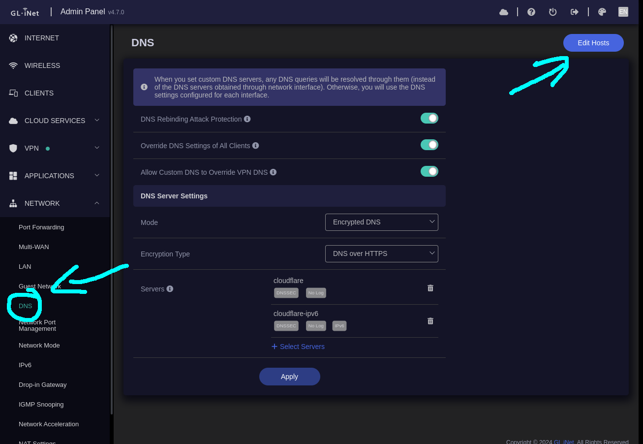

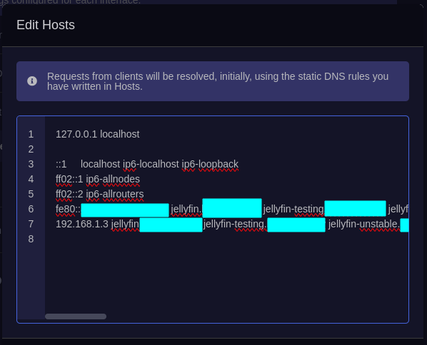

    An example from my router.

    Thank you @TheDreadPirate.  Sadly, I'm afraid my router does not have DNS built-in as this is what the interface looks like:
    I have a netgear nighthawk though, so I assumed it was a decent router and not something locked by my ISP.
