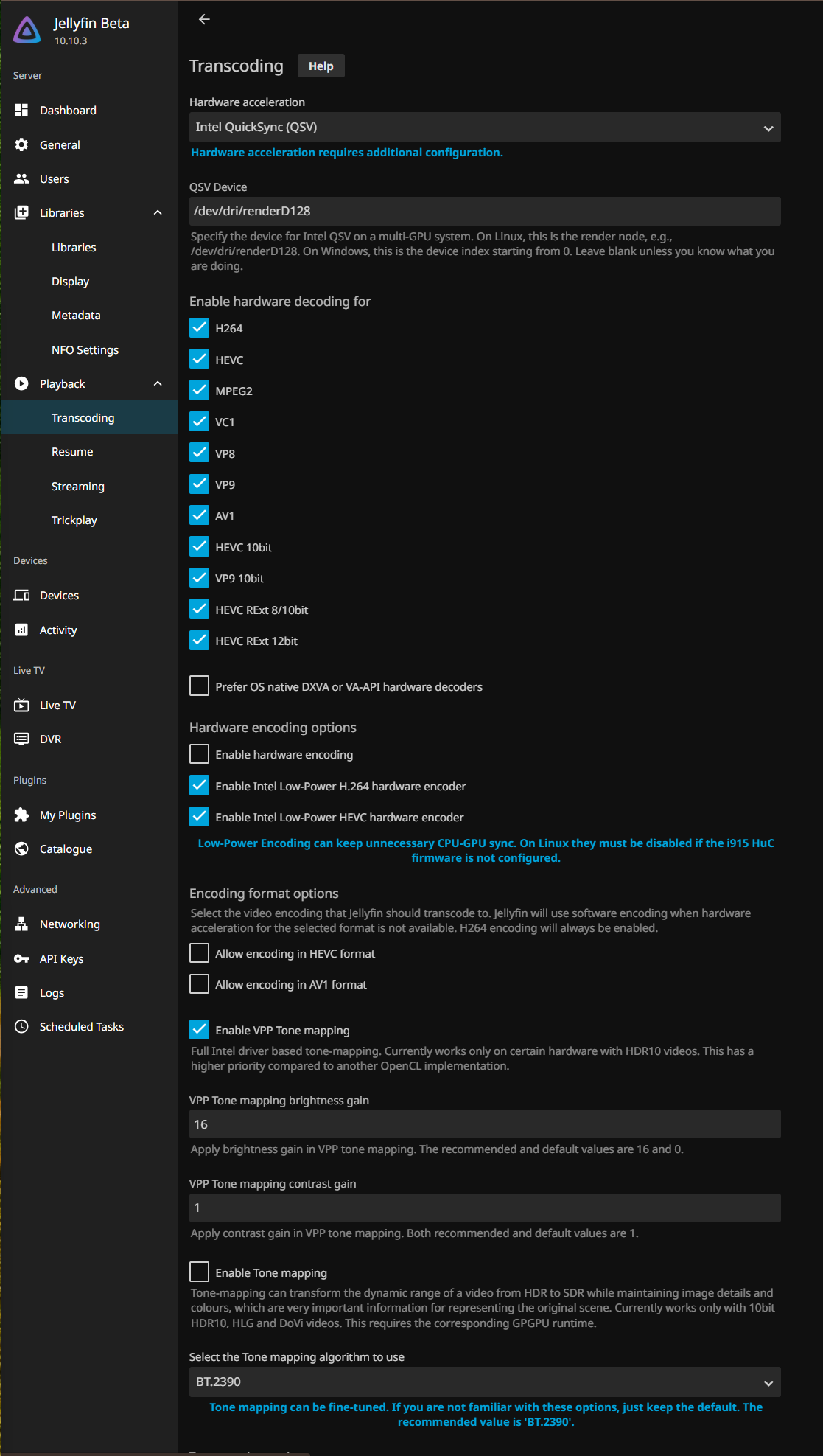

    You didn't enable hardware transcoding. It is still software transcoding. Share screenshots of Dashboard > Playback > Transcoding
    Stream #0:0 -> #0:0 (hevc (hevc_qsv) -> h264 (libx264))
    Also, is the Android phone using the web player or integrated player? Settings > Client settings. The integrated player will have better codec support.

    (2025-01-02, 01:44 PM)TheDreadPirate Wrote: You didn't enable hardware transcoding.  It is still software transcoding.  Share screenshots of Dashboard > Playback > Transcoding
    Thanks for the quick reply, from what I think I have Hardware Transcoding activated. Find attached the Settings Screenshot.
    Okay will take a look in the app, thanks for pointing me towards it!
    edit: Changed it to integrated player like you said. Transcoding stopped <3

    You did not check the box "enable hardware encoding". You can also check "allow encoding in HEVC format" and both tone mapping boxes.

    (2025-01-02, 02:44 PM)TheDreadPirate Wrote: You did not check the box "enable hardware encoding".  You can also check "allow encoding in HEVC format" and both tone mapping boxes.
    If I do this my transcoding from a different content fails, below is the ffmpeg log which kinda gives me the feeling i still have misconfigured it yet.

    I see that you enabled low power encoding. Did you install and setup the GuC and HuC firmware?
    https://jellyfin.org/docs/general/admini...r-encoding
    Those two settings are optional, btw. You can disable them if you don't want to bother setting up the firmware.

    2025-01-02, 06:06 PM (This post was last modified: 2025-01-02, 06:07 PM by bentrades. Edited 1 time in total.)
    I did the driver activation but are unable to get it working with both low power encoders checked.
    However I was able I think to set up Hardware Based Transcoding and are now at 41 FPS when transcoding a HEVC 10bit SDR with 16 mbits to 15. And now really the CPU is just idling around how I expected it to be. Assuming i have reached the right configuration.

    frame= 33 fps= 33 q=-0.0 size=N/A time=00:00:00.87 bitrate=N/A speed=0.876x
    frame= 54 fps= 36 q=-0.0 size=N/A time=00:00:01.75 bitrate=N/A speed=1.17x
    [hls @ 0x5eac22f6ef40] Opening '/config/cache/transcodes/44523164c44ca1a35593492e9099b7d641.mp4' for writing
    frame= 77 fps= 38 q=-0.0 size=N/A time=00:00:02.71 bitrate=N/A speed=1.36x
    frame= 97 fps= 39 q=-0.0 size=N/A time=00:00:03.58 bitrate=N/A speed=1.43x
    frame= 119 fps= 40 q=-0.0 size=N/A time=00:00:04.46 bitrate=N/A speed=1.49x
    frame= 145 fps= 41 q=-0.0 size=N/A time=00:00:05.54 bitrate=N/A speed=1.58x
    [hls @ 0x5eac22f6ef40] Opening '/config/cache/transcodes/44523164c44ca1a35593492e9099b7d642.mp4' for writing
    Ubuntu 24.04 LTS on Proxmox VE 8.2.4
    Intel i5 11400
