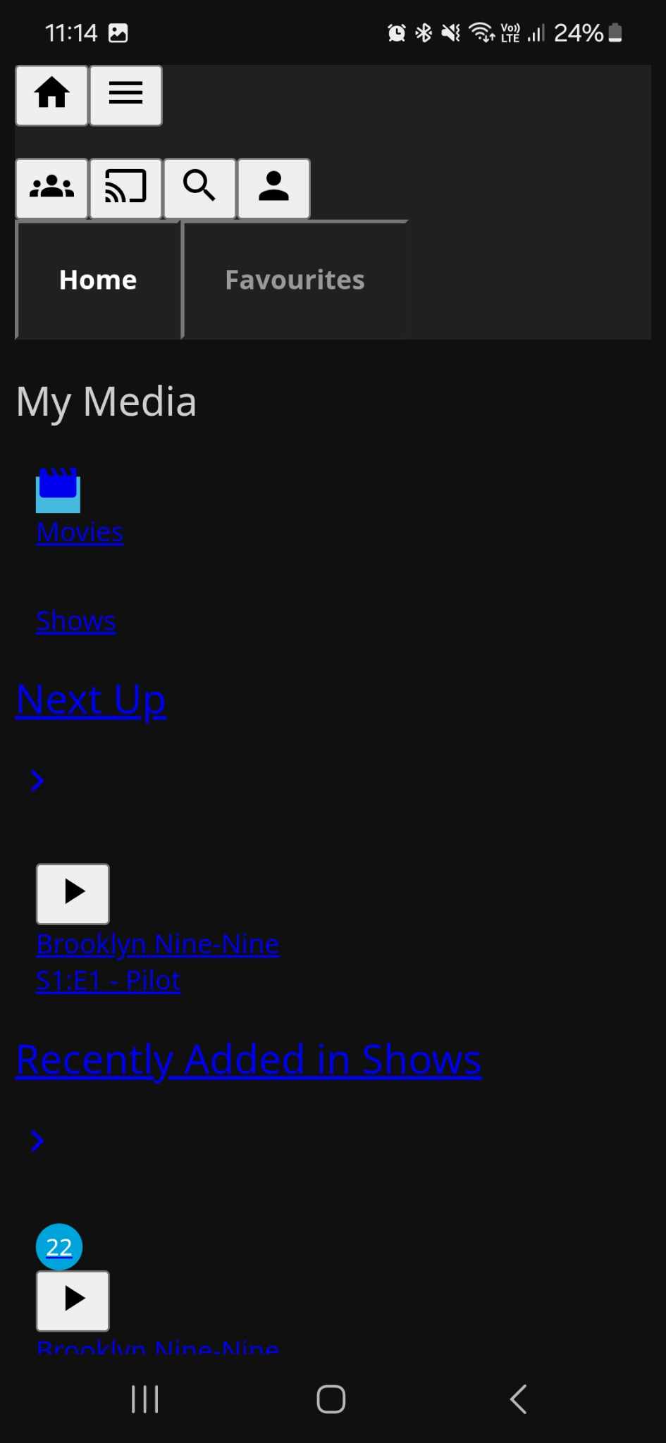

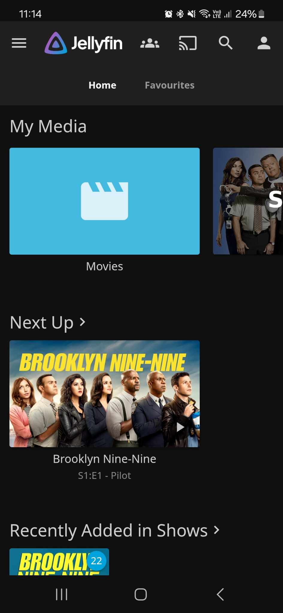

    Hi I am using Jellyfin Android 2.6.2 on my phone. When I first downloaded and installed the app and added my home server with a personal https domain over cloudflare tunnel, everything worked fine. The next day when I went to log in the UI graphics had broken down. The home server is running a linux docker 10.10.5 version and the webpage UI works fine as it should normally however the android phone app doesn't work as it should. The same cloudflare tunnel link on my chrome browser works as usual but on android app, it breaks the UI. When I switch back to my internal private network domain, the app seems to be working fine again. I have checked the logs and there was a slight error message saying "ipv6 is disabled in jellyfin, but enabled in the os. this may affect how the interface is selected error". To resolve this issue, I enabled iPv6 on the server and the error message went away but the UI still does not work/load properly. You can see the differences in the UI when I access from local network and public cloudflare tunnel domain.

    First, using cloudflare tunnels is against their TOS. Second, using cloudflare tunnels can often cause weird, otherwise unexplainable, problems like this.
    Clear the Android app cache, try switching to DNS only in the Cloudflare dashboard, and try reproducing the problem.
