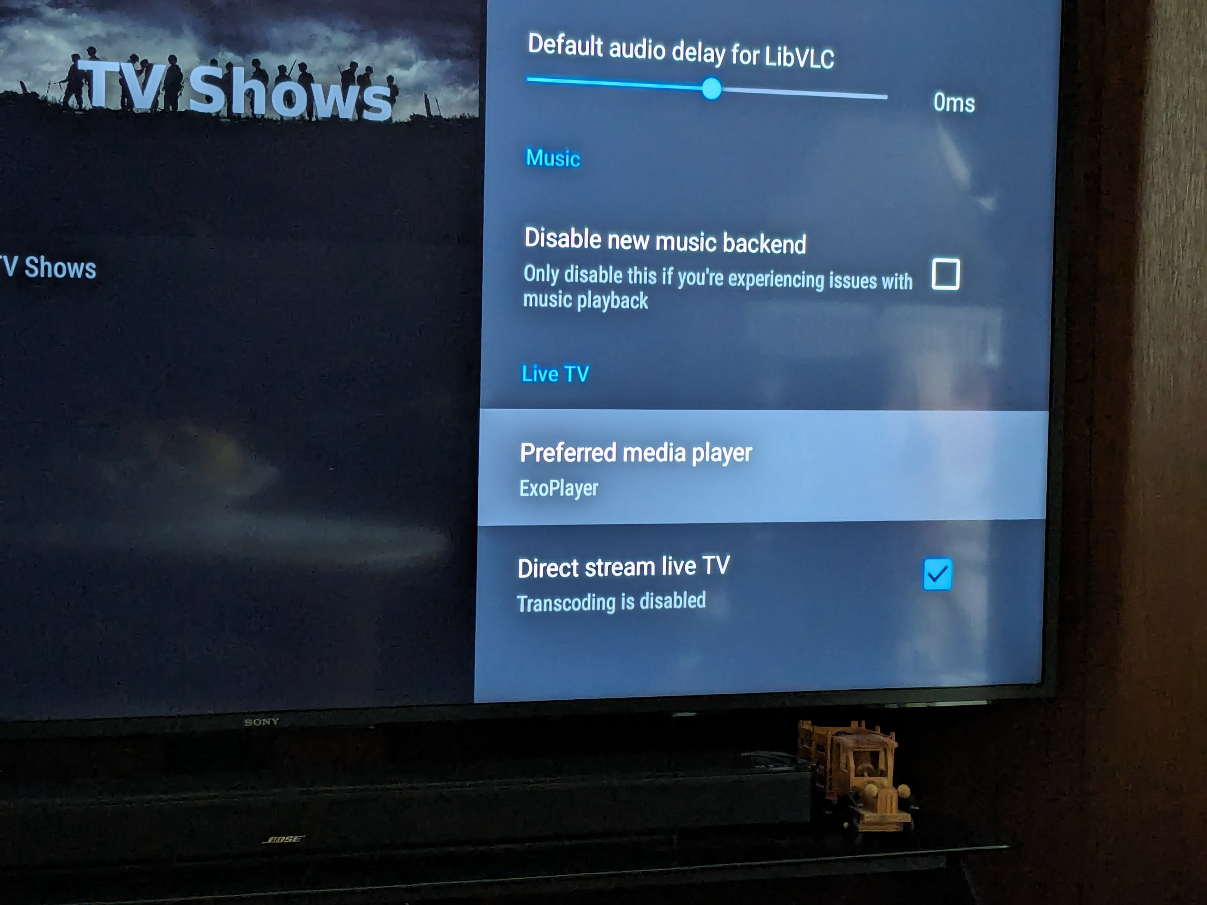

    In your Android TV, on the home screen go to the settings in the top right, Playback, and then go to the bottom and set the preferred media player to exoplayer and check "direct stream live TV".

    2024-01-01, 09:03 PM (This post was last modified: 2024-01-02, 05:15 AM by andaconda. Edited 2 times in total.)
    Couldn't find that setting.
    I do notice that it exhibits the same thing in the Kodi app. Recorded programs play fine, but when trying to watch live tv with the app it does the same audio lag
    But there is no lag when I switch to the TV's native tv app there is no lag.
