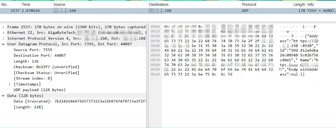

    I captured the response UDP packet with wireshark running in the server to further confirm what I saw in client:
    Any suggestions on what I could tweak in the config for the server auto discovery to return the address https://htpc.mydomain.whatever:8920 as a response to client broadcasts?

    Dashboard-> Networking
    Specify the published server url to
    all=htpc.mydomain.whatever

    2024-08-30, 01:39 AM
    (2024-08-29, 11:25 PM)crobibero Wrote: Dashboard-> Networking
    Thank you very much, crobibero!
    Latest packet capture of the UDP response:
