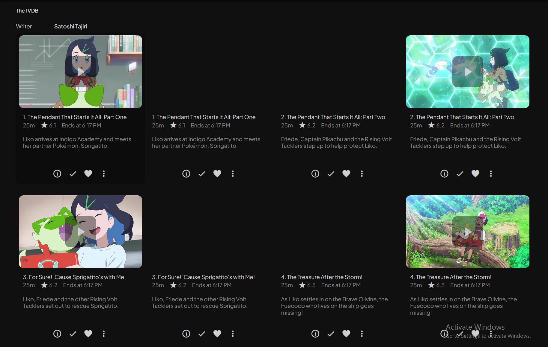

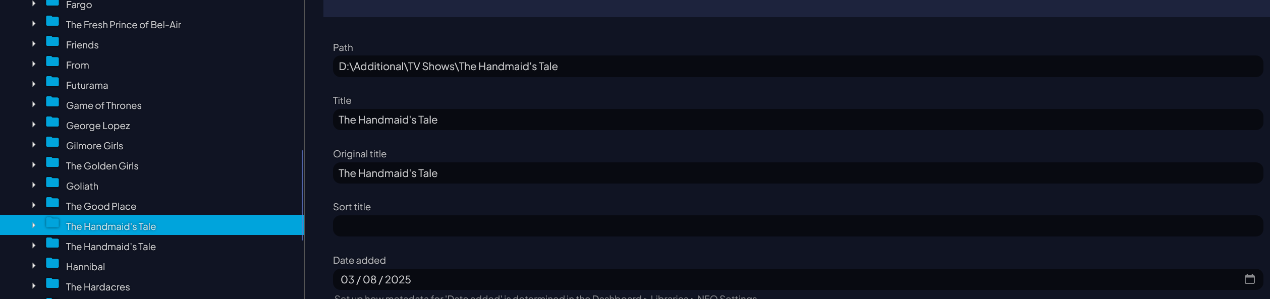

    I was re-organizing my library and reducing the file size of various shows where possible. This process included removing a select show/season out of its respective library/drive, either replacing the video files with smaller ones or just taking it out to put into a new drive then scanning the library, making sure the show/season disappeared from the library and making sure the metadata no longer showed for that show/season, then putting the files back in once ready. This would typically work before when doing so, however once the show/season was added back - it doubled up the episodes and made the respective poster blurry as well as showing the original path in the metadata manager.
    Here are images for both the blank episodes and metadata manager doubling the series for Pokemon and The Handmaid's Tale.

    So I tried this and nothing changed so I went through and each series that was having the issue I made "scan for new and updated files" and that worked to get rid of the blank episodes and blurry poster images, however - it simply fixes it by recreating the relevant files in the ORIGINAL location the file was in before I moved anything around. It is like the server is refusing to update the location for each episode from the old drive to the new
    for clarification - say Pokemon was in two locations originally, drive 1 under "Drive > additional > Kids TV > Pokemon > Season 20" and drive 2 under "Drive 2 > Kids TV > Pokemon > every other season". The goal was to simply move season 20 to drive 2 so it is all under a single location. For some reason, jellyfin is insisting that season 20 is still on drive 1 so it is looking for it there. But it isn't, if I scan in any way - it remakes the images/metadata relevant to the series in the original location.
