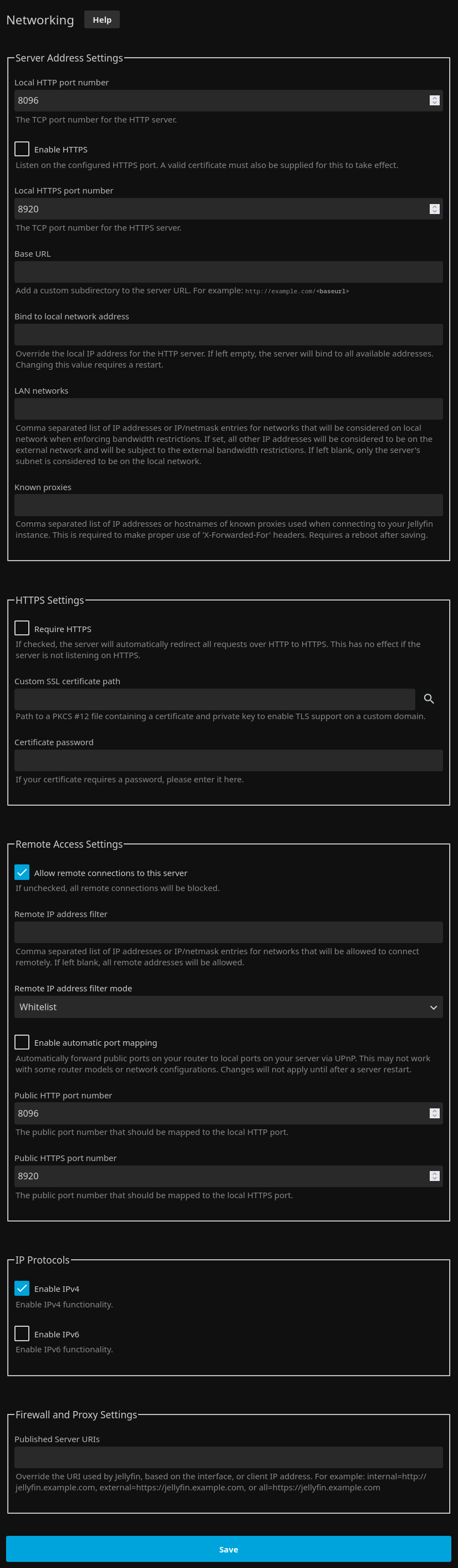

    Can you also share screenshots of the config UI for Jellyfin?

    Not the Jellyfin network config page. There should be a config page within TrueNAS for Jellyfin.
    It looks like you are using bridge networking. Did you publish port 8096?

    Those pages?

    The TrueNAS "app store" version of Jellyfin is mapping port 30013 on the host to 8096 for the container. You can either reconfigure the container to use 8096 on the host or have your clients use port 30013.
    http://192.168.#.#:30013
