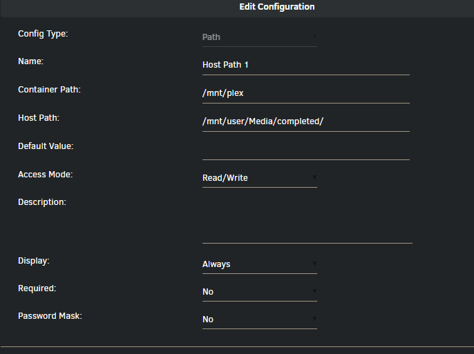

    I am running all of the *arrs,Jellyfin and autoscan on unraid through dockers.
    All of the libraries are set to the same mount points of /mnt/plex(When I switched from plex I never changed the naming)

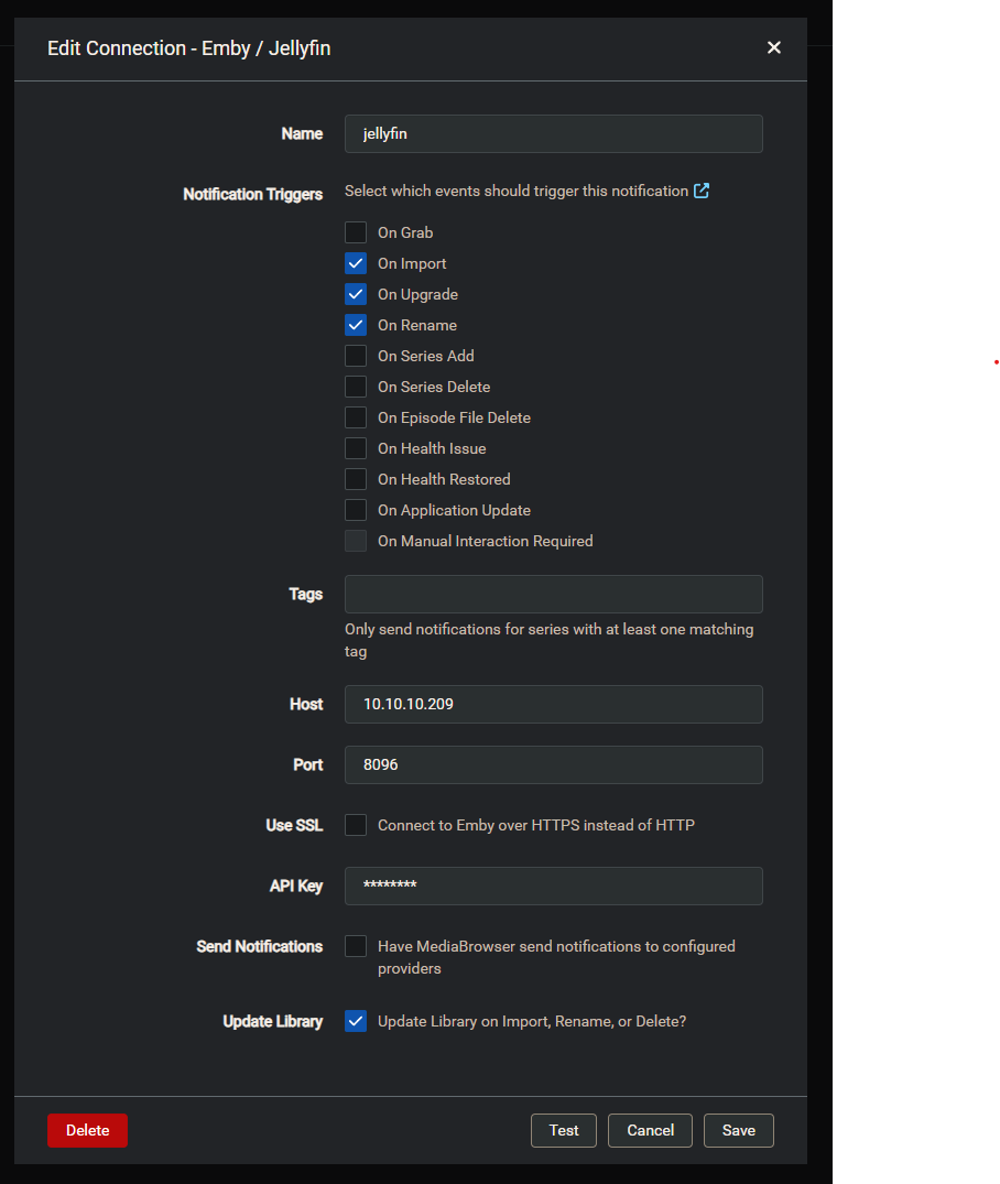

    On jellyfin connect: tick "on import", "on upgrade", "on renamed", "Update Library". That should trigger a library scan on jellyfin.

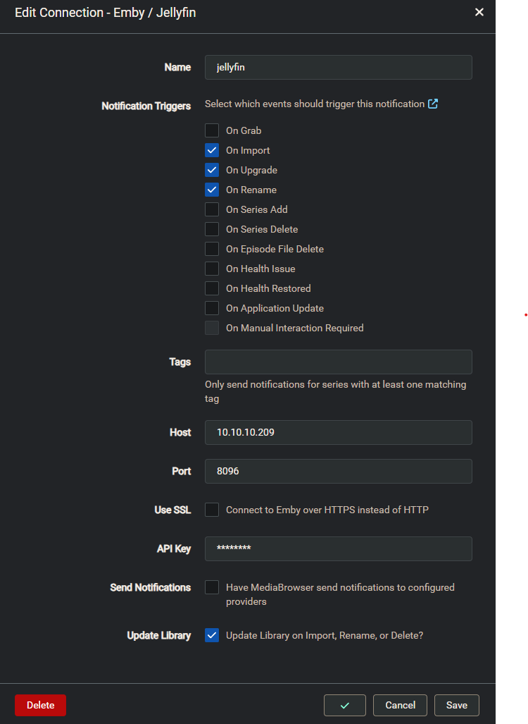

    I have sonarr setup as seen in the screenshot. I am still seeing files not updating properly and needing to do a Metadata update in jellyfin. Been doing this atleast once a day.

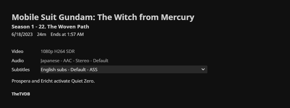

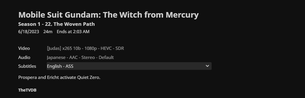

    --Sonarr is setup to grab files and I have a few releasers that are preferred, so if it finds one with the releaser I prefer then it will grab that instead to "upgrade" the existing file to or if it upgrades from 720p to 1080p. I expect Jellyfin to see that the file has changed and to update accordingly. As of now it does not see these changes and until I do a manual refresh metadata--> replace all metadata(I use NFO files and currently no other metadata) the file does not update and is not playable within jellyfin.

    --The media is stored on unraid on drives formated to XFS. Using unraid dockers I have it mounted. I had autoscan setup because it was recommended via the discord but since it has not helped, I stopped it as of this morning.

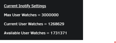

    The *arrs and Jellyfin all have the exact same mapping just for consistancy sake. Unraid does support Inotify and I have attached a screenshot of its current amount. The *arrs confirm that they can communicate to jellyfin via the api call.
