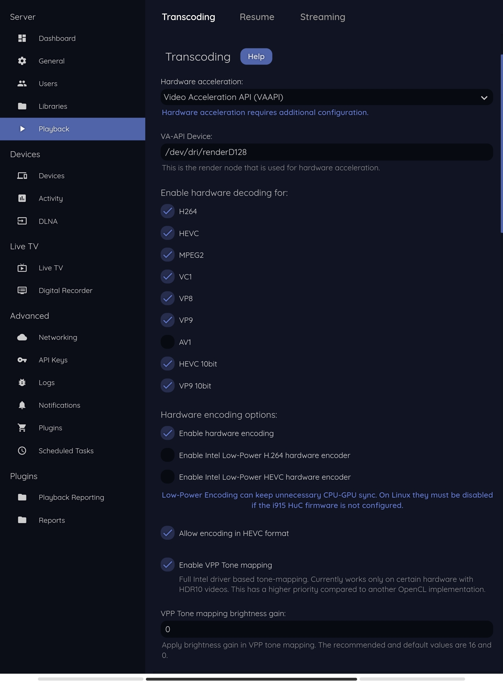

    • Ubuntu 18.04
    • iGPU enabled with https://github.com/desimaniac/docs/blob/...hetzner.md
    • Jellyfin 10.8.10 from docker jellyfin/jellyfin:latest
    • My Jellyfin transcoding settings (see picture attached)
    ISSUE:
    Hardware accelerated transcoding works fine in Plex (docker) but it doesn't with Jellyfin. 'This client isn't compatible with the media and the server isn't sending a compatible media format.'
    I tried VAAPi and QSV but same resulg

    nyanmisaka
    Posts: 307
    Reputation: 18
    2023-07-02, 06:24 PM
    Quote:[hevc @ 0x5601940418c0] No support for codec hevc profile 2.
    [hevc @ 0x5601940418c0] Failed setup for format vaapi: hwaccel initialisation returned error.
    [AVHWDeviceContext @ 0x55e1c1a457c0] 0.0: Intel® OpenCL HD Graphics / Intel® HD Graphics 530 [0x1912]
    Your iGPU HD 530 has no support for HEVC 10-bit decoding. HDR tone-mapping can be very slow.
    Please disable the "HEVC 10-bit decoding" in Dashboard->Playback and try again.
    soy_titooo
    Posts: 12
    2023-07-10, 08:32 AM
    It was that simple! Thank you.
    It's a shame that my Hetzner server can't do "HEVC 10-bit decoding" but at least I know now!
