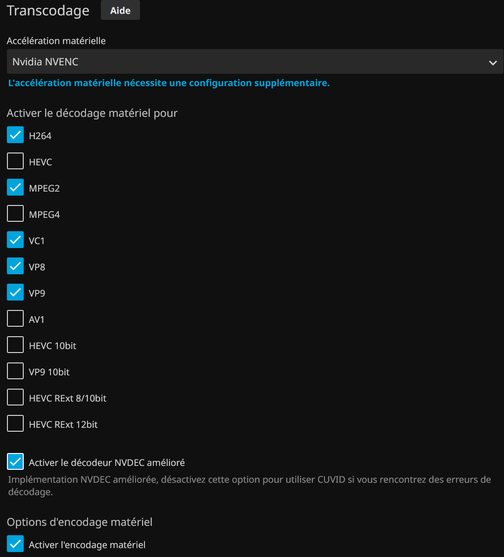

    Jellyfin NVIDIA Hardware Transcoding Issue on Debian with Quadro P620
    Environment
    - **OS**: Debian GNU/Linux 12 (bookworm)
    - **Kernel**: 6.1.0-28-amd64
    - **GPU**: NVIDIA Quadro P620
    - **Driver Version**: 535.183.01
    - **Container**: Jellyfin (lscr.io/linuxserver/jellyfin:latest)
    Issue Description
    I recently installed a Quadro P620 GPU for hardware transcoding in Jellyfin. While the GPU is properly detected both on the host system and inside the Docker container, FFmpeg fails to initialize CUDA for transcoding with an error related to loading the CUDA library.
    Attempted Solutions
    I have already tried several solutions suggested in these forum posts:
    - Verifying NVIDIA runtime is properly installed and configured in Docker
    - Adding all necessary GPU capabilities in docker-compose file
    - Setting NVIDIA_DRIVER_CAPABILITIES and NVIDIA_VISIBLE_DEVICES to "all"
    - Ensuring proper permissions for the Jellyfin user in the container
    - Checking if CUDA libraries are present in the container
    - Verifying GPU detection using nvidia-smi both on host and in container
    None of these common solutions have resolved the issue.

    Error Message
    When attempting to play a video file, FFmpeg logs show:
    [AVHWDeviceContext @ 0x55ab2d7c1d00] Cannot load libcuda.so.1
    [AVHWDeviceContext @ 0x55ab2d7c1d00] Could not dynamically load CUDA
    Device creation failed: -1.
    Failed to set value 'cuda=cu:0' for option 'init_hw_device': Operation not permitted
    Error parsing global options: Operation not permitted
    Additional Information
    - The GPU is properly detected inside the container (verified using nvidia-smi)
    - NVIDIA runtime is properly configured in Docker
    - FFmpeg is built with NVIDIA support (as shown in the configuration output)
    Any assistance would be greatly appreciated.

    Stream mapping:
      Stream #0:0 -> #0:0 (av1 (libdav1d) -> h264 (h264_nvenc))
      Stream #0:2 -> #0:1 (ac3 (native) -> aac (libfdk_aac))
    [h264_nvenc @ 0x556f3a98ae00] Cannot load libnvidia-encode.so.1
    [h264_nvenc @ 0x556f3a98ae00] The minimum required Nvidia driver for nvenc is 520.56.06 or newer
    [vost#0:0/h264_nvenc @ 0x556f3afbeb40] Error while opening encoder - maybe incorrect parameters such as bit_rate, rate, width or height.
    [vf#0:0 @ 0x556f3aa27f00] Error sending frames to consumers: Operation not permitted
    [vf#0:0 @ 0x556f3aa27f00] Task finished with error code: -1 (Operation not permitted)
    [vf#0:0 @ 0x556f3aa27f00] Terminating thread with return code -1 (Operation not permitted)
    [vost#0:0/h264_nvenc @ 0x556f3afbeb40] Could not open encoder before EOF
    [vost#0:0/h264_nvenc @ 0x556f3afbeb40] Task finished with error code: -22 (Invalid argument)
    [vost#0:0/h264_nvenc @ 0x556f3afbeb40] Terminating thread with return code -22 (Invalid argument)
    [out#0/hls @ 0x556f3b553e00] Nothing was written into output file, because at least one of its streams received no packets.
    frame=    0 fps=0.0 q=0.0 Lsize=      0KiB time=N/A bitrate=N/A speed=N/A
    Conversion failed!
    GuigZer
    Joined: 2024 Nov
    Country:France
    2024-11-26, 09:49 AM
    Second UPDATE :
    So i do a
    sudo apt install libnvidia-encode1
    and
    └─$ nvidia-smi
    Tue Nov 26 10:48:25 2024
    | NVIDIA-SMI 535.183.01            Driver Version: 535.183.01  CUDA Version: 12.2    |
    | GPU  Name                Persistence-M | Bus-Id        Disp.A | Volatile Uncorr. ECC |
    | Fan  Temp  Perf          Pwr:Usage/Cap |        Memory-Usage | GPU-Util  Compute M. |
    |                                        |                      |              MIG M. |
    |  0  Quadro P620                    Off | 00000000:02:00.0 Off |                  N/A |
    | 34%  49C    P0              N/A /  N/A |    240MiB /  2048MiB |    88%      Default |
    |                                        |                      |                  N/A |
    | Processes:                                                                            |
    |  GPU  GI  CI        PID  Type  Process name                            GPU Memory |
    |        ID  ID                                                            Usage      |
    |    0  N/A  N/A    467531      C  /usr/lib/jellyfin-ffmpeg/ffmpeg            238MiB |
    Now it work's !
