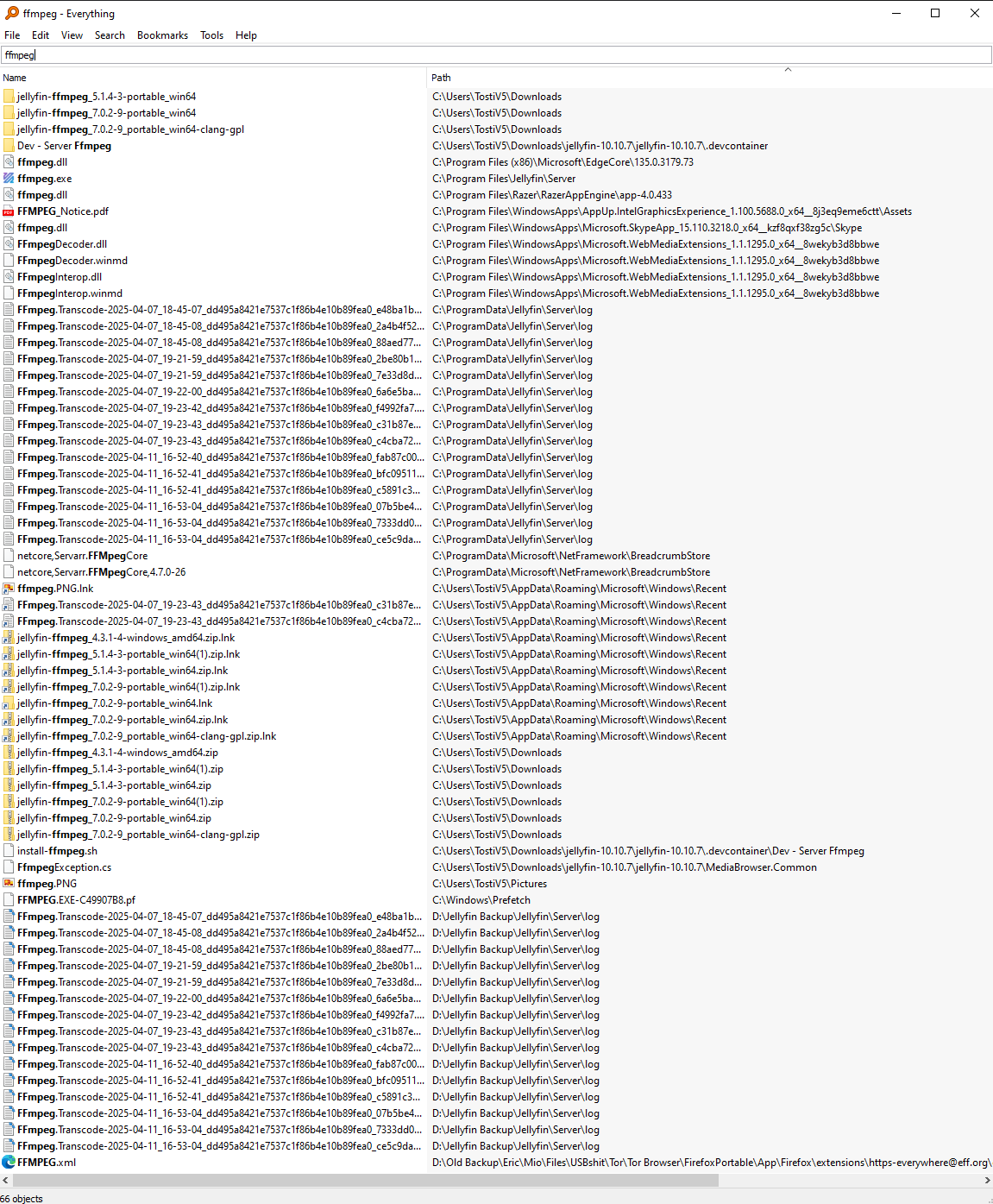

    Nothing comes up in the control panel or the add/remove programs. Even when typing ffmpeg in the star menu nothing comes up. I can also verify that if I had to install it in order to have it I've never done it... The only thing I did was download the jellyfin-ffmpeg, extract and replace everything in the Jellyfin folder.
    Also video playback work if I disable hardware acceleration, of course is incredibly laggy and can barely transcode 1 video, enabling HW accel on Intel or NVEC both fail.

    2025-04-13, 04:07 PM
    If you open Voidtool's "Everything" app, do you see ffmpeg.exe listed?

    2025-04-13, 07:20 PM (This post was last modified: 2025-04-13, 07:21 PM by Raymagini24. Edited 1 time in total.)
    I only see ffmpeg on jellyfin and the different downloaded zip files I've tried.
    2025-04-13, 07:55 PM
    I see that you have a custom ffmpeg build in your downloads, which matches the version that Jellyfin is calling.
    Read the guide below. Start at step 3 to see if you've setup an environment variable to use this custom ffmpeg build.
