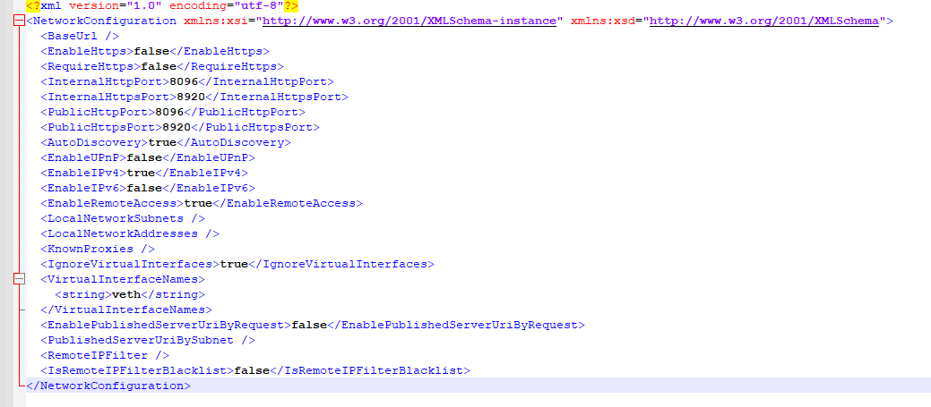

    CreekyBones85
    2024-09-17, 11:54 AM
    I am having a similar issue with connecting over meshnet. Odd thing is it was working just straight out of the box but not its not. Here's my network config file as well.
    <?xml version="1.0" encoding="utf-8"?>
    <NetworkConfiguration xmlns:xsi="http://www.w3.org/2001/XMLSchema-instance" xmlns:xsd="http://www.w3.org/2001/XMLSchema">
      <BaseUrl />
      <EnableHttps>false</EnableHttps>
      <RequireHttps>false</RequireHttps>
      <InternalHttpPort>8096</InternalHttpPort>
      <InternalHttpsPort>8920</InternalHttpsPort>
      <PublicHttpPort>8096</PublicHttpPort>
      <PublicHttpsPort>8920</PublicHttpsPort>
      <AutoDiscovery>true</AutoDiscovery>
      <EnableUPnP>false</EnableUPnP>
      <EnableIPv4>true</EnableIPv4>
      <EnableIPv6>false</EnableIPv6>
      <EnableRemoteAccess>true</EnableRemoteAccess>
      <LocalNetworkSubnets />
      <LocalNetworkAddresses />
      <KnownProxies />
      <IgnoreVirtualInterfaces>true</IgnoreVirtualInterfaces>
      <VirtualInterfaceNames>
        <string>veth</string>
      </VirtualInterfaceNames>
      <EnablePublishedServerUriByRequest>false</EnablePublishedServerUriByRequest>
      <PublishedServerUriBySubnet />
      <RemoteIPFilter />
      <IsRemoteIPFilterBlacklist>false</IsRemoteIPFilterBlacklist>
    </NetworkConfiguration>
    Could the problem be "IgnoreVirtualInterfaces" being true?
    2024-09-17, 02:06 PM
    (2024-09-17, 11:54 AM)CreekyBones85 Wrote: Could the problem be "IgnoreVirtualInterfaces" being true?
    That is the default value.  It would only be a problem if Jellyfin is in a VM and your VM happens to have interface names like that.
    Can you describe your setup and provide jellyfin logs via pastebin?
