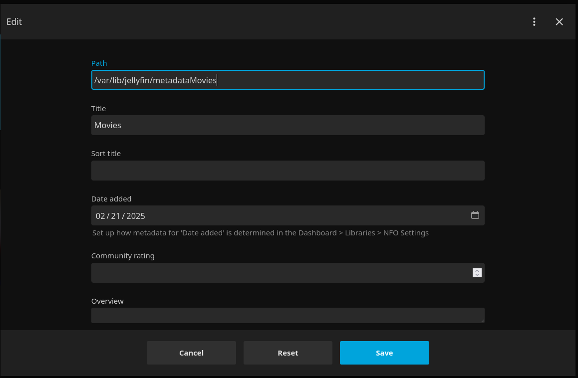

    it is perhaps worth noting that the metadata for the Movies library is stored in a weird (and possibly invalid?) location as of ~february 21, 2025--i am not sure what caused this. according to jellyfin's Metadata Manager tab, Movies metadata is stored in /var/lib/jellyfin/metadataMovies, which is possibly related to this issue of jellyfin not being able to (see/find) my movie files... (for comparison, Shows metadata has been stored in /var/lib/jellyfin/root/default/Shows since february 21, 2025.)

    both drives are formatted as BTRFS. i ran the command you mentioned for ext4 and other native Linux file systems. my Movies library is...still empty. could the invalid filepath for the Movies metadata i mentioned in my original post have something to do with this? (and how would i edit where jellyfin stores the metadata for the Movies library?)
    for reference, i've attached a screenshot of the "Edit Metadata" popup for my Movies library.
