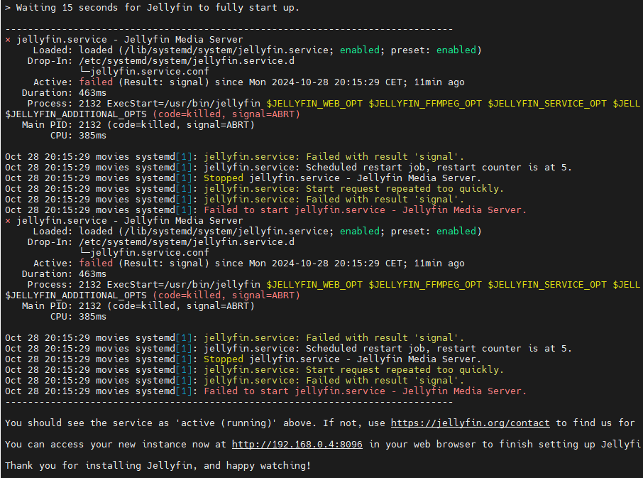

    I used Jellyfin for some weeks now and everything worked well.
    Since 1 or 2 days ago, the service don't want to start.
    The error is :
    × jellyfin.service - Jellyfin Media Server
        Loaded: loaded (/lib/systemd/system/jellyfin.service; enabled; preset: enabled)
        Drop-In: /etc/systemd/system/jellyfin.service.d
                └─jellyfin.service.conf
        Active: failed (Result: signal) since Mon 2024-10-28 20:15:29 CET; 11min ago
      Duration: 463ms
        Process: 2132 ExecStart=/usr/bin/jellyfin $JELLYFIN_WEB_OPT $JELLYFIN_FFMPEG_OPT $JELLYFIN_SERVICE_OPT $JELL$JELLYFIN_ADDITIONAL_OPTS (code=killed, signal=ABRT)
      Main PID: 2132 (code=killed, signal=ABRT)
            CPU: 385ms
    Oct 28 20:15:29 movies systemd[1]: jellyfin.service: Failed with result 'signal'.
    Oct 28 20:15:29 movies systemd[1]: jellyfin.service: Scheduled restart job, restart counter is at 5.
    Oct 28 20:15:29 movies systemd[1]: Stopped jellyfin.service - Jellyfin Media Server.
    Oct 28 20:15:29 movies systemd[1]: jellyfin.service: Start request repeated too quickly.
    Oct 28 20:15:29 movies systemd[1]: Failed to start jellyfin.service - Jellyfin Media Server.
      Duration: 463ms
            CPU: 385ms
    The only think I changed is the encodeur I think but since, I did an "apt remove jellyfin" and remove the jellyfin.source from apt and reinstall the tool from "curl https://repo.jellyfin.org/install-debuntu.sh | sudo bash"
    If someone has any idea Smiling-face

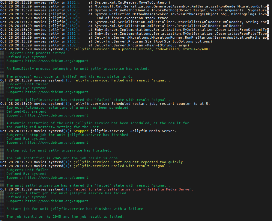

    Journalctl -xeu jellyfin :
    Oct 28 20:15:29 movies jellyfin[2132]:    at System.Xml.XmlReader.MoveToContent()
    Oct 28 20:15:29 movies jellyfin[2132]:    at Microsoft.Xml.Serialization.GeneratedAssembly.XmlSerializationRead>
    Oct 28 20:15:29 movies jellyfin[2132]:    at System.RuntimeMethodHandle.InvokeMethod(Object target, Void** argu>
    Oct 28 20:15:29 movies jellyfin[2132]:    at System.Reflection.MethodBaseInvoker.InvokeWithNoArgs(Object obj, B>
    Oct 28 20:15:29 movies jellyfin[2132]:    --- End of inner exception stack trace ---
    Oct 28 20:15:29 movies jellyfin[2132]:    at System.Xml.Serialization.XmlSerializer.Deserialize(XmlReader xmlRe>
    Oct 28 20:15:29 movies jellyfin[2132]:    at Emby.Server.Implementations.Serialization.MyXmlSerializer.Deserial>
    Oct 28 20:15:29 movies jellyfin[2132]:    at Jellyfin.Server.Migrations.MigrationRunner.RunPreStartup(ServerApp>
    Oct 28 20:15:29 movies jellyfin[2132]:    at Jellyfin.Server.Program.StartApp(StartupOptions options)
    Oct 28 20:15:29 movies jellyfin[2132]:    at Jellyfin.Server.Program.<Main>(String[] args)
    Oct 28 20:15:29 movies systemd[1]: jellyfin.service: Main process exited, code=killed, status=6/ABRT
    ░░ Subject: Unit process exited
    ░░ Defined-By: systemd
    ░░ Support: https://www.debian.org/support
    ░░ An ExecStart= process belonging to unit jellyfin.service has exited.
    ░░ The process' exit code is 'killed' and its exit status is 6.
    ░░ Subject: Unit failed
    ░░ The unit jellyfin.service has entered the 'failed' state with result 'signal'.
    ░░ Subject: Automatic restarting of a unit has been scheduled
    ░░ Automatic restarting of the unit jellyfin.service has been scheduled, as the result for
    ░░ the configured Restart= setting for the unit.
    ░░ Subject: A stop job for unit jellyfin.service has finished
    ░░ A stop job for unit jellyfin.service has finished.
    ░░ The job identifier is 2945 and the job result is done.
    ░░ Subject: A start job for unit jellyfin.service has failed
    ░░ A start job for unit jellyfin.service has finished with a failure.
    ░░ The job identifier is 2945 and the job result is failed.

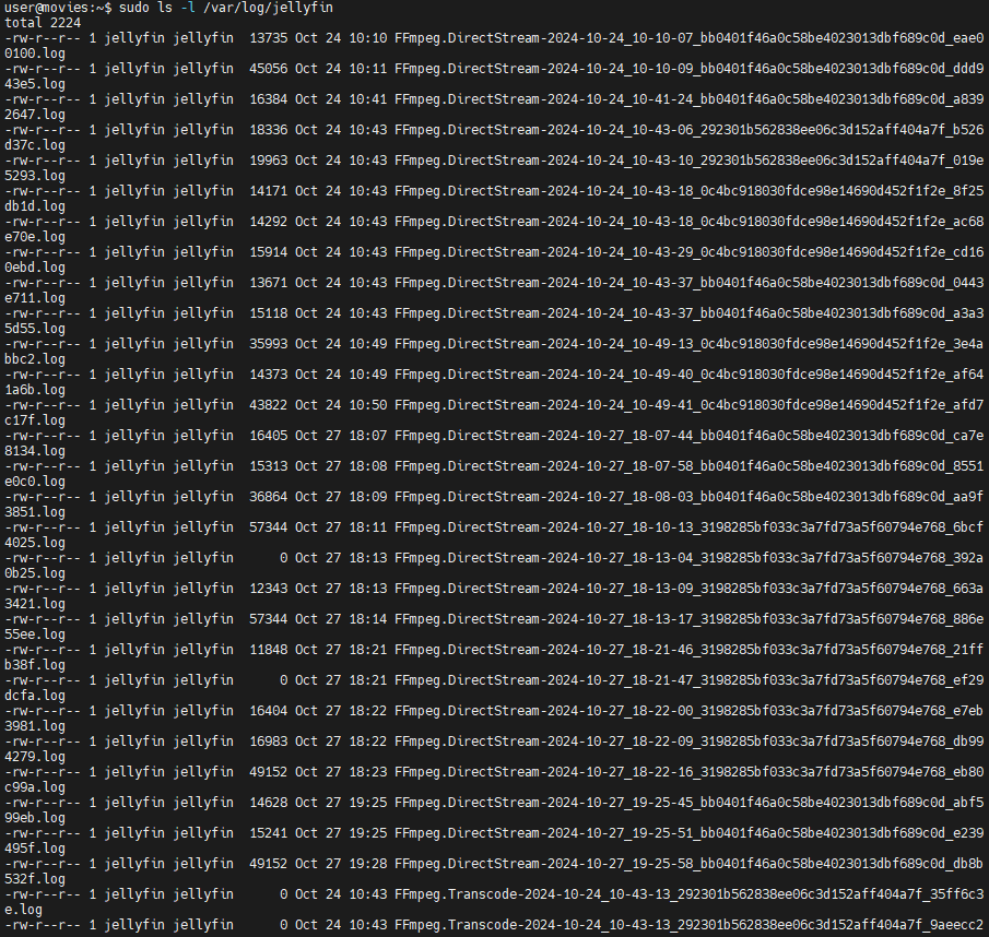

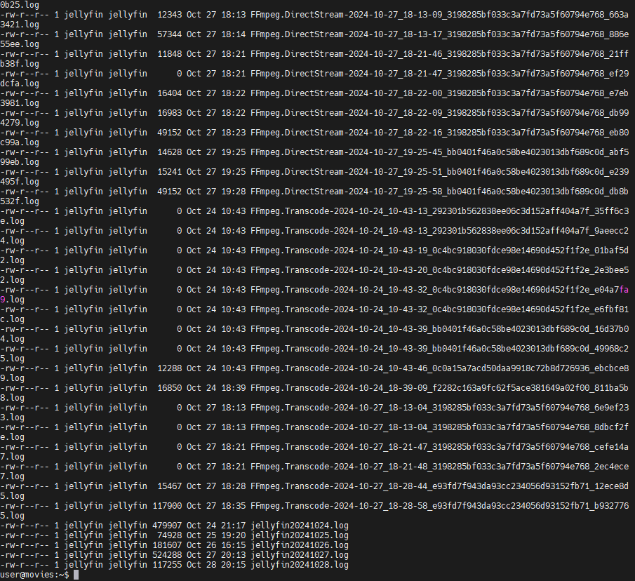

    The logs are not reachable :
    sudo cd /var/log/jellyfin/
    sudo: cd: command not found
    sudo: "cd" is a shell built-in command, it cannot be run directly.
    sudo: the -s option may be used to run a privileged shell.
    sudo: the -D option may be used to run a command in a specific directory.
    and "ls -l /var/log/jellyfin give me results (see in attachment)
