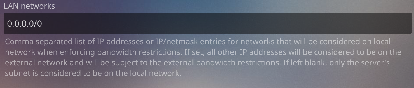

    For one last test, can you try set LAN networks to 0.0.0.0/0 in Dashboard->Networking, and then restart both the server and the app and try again? If this solved the issue then it is indeed the bitrate testing working abnormally.
