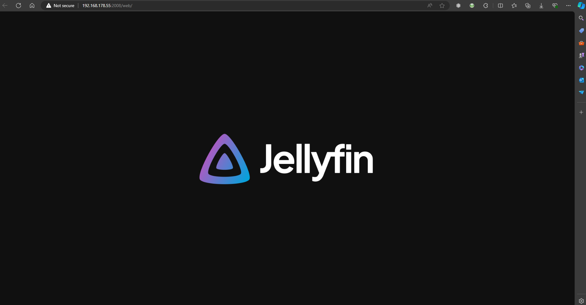

    I need to clarify that there is no issue with mapping the port from the container to my custom host port because jellyfin is reachable on the custom port. The problem is that when accessing http://192.168.178.55:2008 the jellyfin logo immediately pops up and then the web client seems to stuck then. I am not forwarded or shown the server selection or login screen. Ist just the logo popping up, nothing else.

    2024-08-14, 04:03 PM
    In your opening post you said 10.9.4, but your log says 10.9.9. If you upgraded recently, try clearing your browser cache or opening an incognito window. There were big changes in 10.9.9 that re-worked how Jellyfin caches browser data.

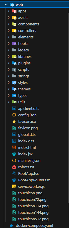

    Here is also the "web" folder where I copied the src folder of the official web client github repository.
    Is this the right folder structure, because I am unsure if that is causing the problem?

    2024-08-14, 05:48 PM
    Why did you manually copy jellyfin-web? The docker image comes with it. This may be the problem.
    Comment out the volume for /web and the environment variable for /web in your compose and recreate the container to make sure that everything is reset.
    sudo docker compose up -d jellyfin --force-recreate
    Limos21
    2024-08-14, 07:03 PM
    Finally that solved everything Smiling-face !!!! Many thanks.
