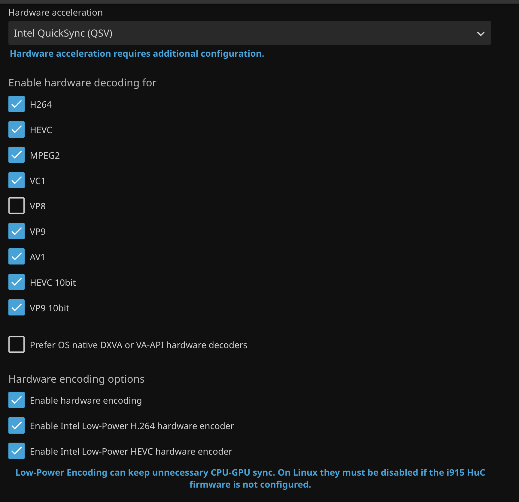

    My transcoding configs:
    I believe the i915 Intel low power transcoding is configured, though my paths are slightly different from what's in the Jellyfin doc:

    Okay, I've made some progress.
    it seems like the iGPU isn't used at all, even for bitrate transcoding. I guess my CPU was handling it okay enough that I never noticed, and maybe codec transcoding is more intensive?
    I tested by transcoding in both JF and Plex and only Plex shows activity in gputop!
    I know that when I select QSV in JF, there's no option to specify the device, unlike with VAAPI which does. On the Plex side I had to manually select my AlderLake device from a dropdown. Could this be why?
    I tried passing /dev/dri/renderD128 directly, but this made no difference.
    Here are the DEBUG logs you requested, while reproducing the issue.
    Container:
    https://drive.google.com/file/d/1o87163z...sp=sharing
    ffmpeg for good measure:
    https://pastebin.com/T3QZvk6R
