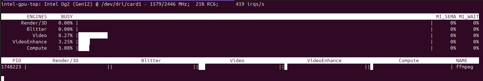

    Yeah that definitely looks like things are working as expected. Are you running intel_gpu_top as sudo? If not, it won't show anything. In fact, it warns me if I ever forget. I just tried to capture that warning and got errors and a core dump...whoops.
    Attaching a screenshot of what intel_gpu_top looks like while I'm transcoding.
    My question for you is this: when you're transcoding does your CPU usage go off the chart?
