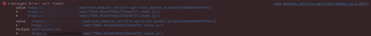

    I am running Jellyfin in Docker following the "latest" tag (currently 10.9.11). As of this evening, all of my media libraries have stopped being able to refresh. I enabled debug logging per the instructions (https://jellyfin.org/docs/general/admini...eshooting/), but even then, there are no logs corresponding to the "refresh metadata" request. (I was following the logs with docker logs -f and nothing was logged when the button was pressed). I attempted to revert to a previously working version (10.9.9) and saw the same issue. I removed the most recent files I added and still the same issue. I'm not sure where else to look to troubleshoot this. The only clue I have is a Devtools JS Console error that consistently appears each time the "Refresh" button is pressed which I have attached a screenshot of. The screenshot was taken in Firefox 129, but the same behavior appears in the Android app (version 2.6.2 if I'm looking correctly). The actual observed behavior in either is pressing the "Refresh" button, then the loading spinner appearing indefinitely rather than the "Refresh Metadata" popup closing and the refresh starting as expected.
    I have a reasonable about of JS experience, but not with Jellyfin's tech stack. If somebody could point me to sourcemaps for this version of Jellyfin I may be able to get more information out of that console error. Otherwise any help to determine what could be causing this would be appreciated.

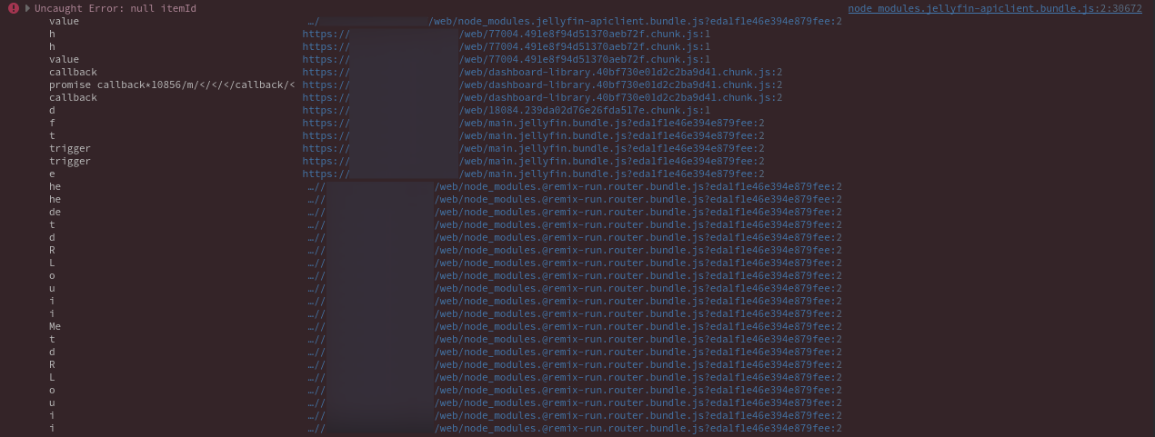

    (2024-09-15, 02:09 AM)TheDreadPirate Wrote: Try clearing your browser cache.
    No luck, unfortunately. The same behavior is present as before clearing the cache. It might not be significant, but the JS stacktrace did change. I attached the new error. Still no change in the logs either.

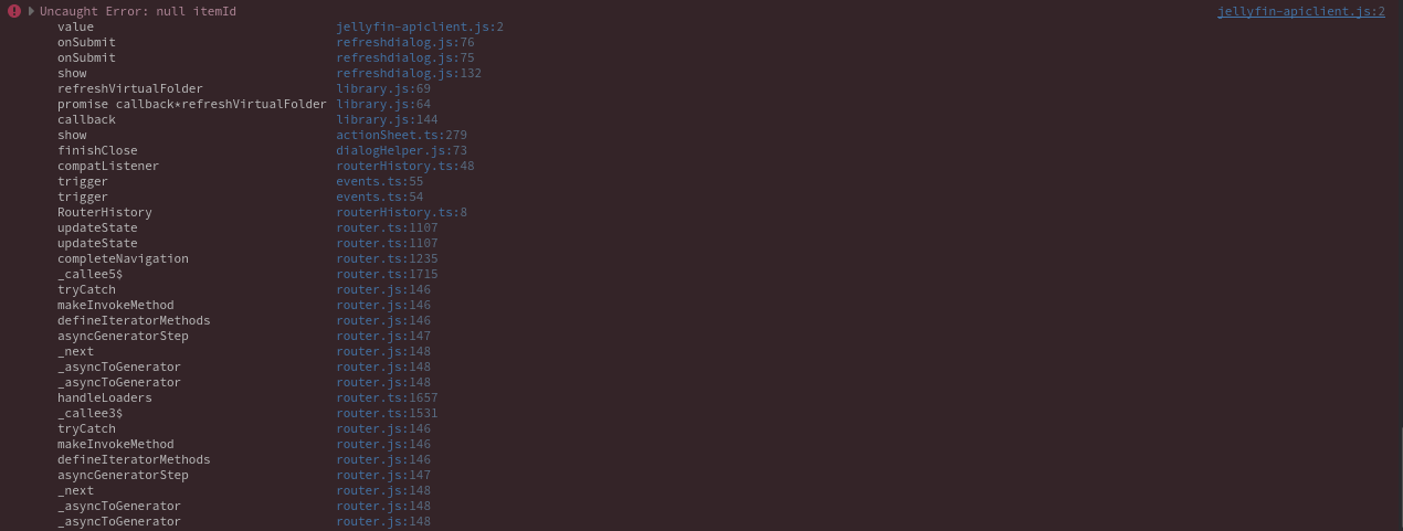

    I really wanted to see what that JS error was about, so I got the jellyfin-packaging repo, changed the jellyfin-web build step to use build:development, built the container with the instructions in the README, copied my /config volume to a brand new volume, and launched the container with the following command:
    docker run --rm \
      -v dev_jellyfin_config:/config \  # copied config volume
      -v dev_jellyfin_cache:/cache \    # empty cache volume
      -v homelab_share:/media \         # SMB volume with my videos in it
      jellyfin/jellyfin:10.9.11-de-amd64.20240915-091159
    The behavior remained in this new container. I got some unrelated errors from my browser because the connection was no longer SSL. But I also got the attached stack trace.
    I'm gonna start digging into this JS to see what I can find. Let me know if you have any other suggestions I can try though.

    I've been digging into the code and what I've found so far is that the function expects an itemId to be in each of the items returned from the "Library/VirtualFolders" endpoint. That endpoint is only returning the following on my instance:
    [{"Name":"Anime","Locations":["/media/video/anime"],"CollectionType":"tvshows"},{"Name":"Shows","Locations":["/media/video/shows"],"CollectionType":"tvshows"},{"Name":"Animated Shows","Locations":["/media/video/animation"],"CollectionType":"tvshows"},{"Name":"Movies","Locations":["/media/video/movies"],"CollectionType":"movies"},{"Name":"Animated Movies","Locations":["/media/video/animated_movies"],"CollectionType":"movies"},{"Name":"Anime Movies","Locations":["/media/video/anime_movies"],"CollectionType":"movies"}]
    This matches the basic information that's constructed by the first half of the Emby.Server.Implementations.Library.LibraryManager.GetVirtualFolderInfo method, but the ItemId, PrimaryImageItemId, LibraryOptions, RefreshProgress, and RefreshStatus from the second half of that function are all missing. There's a not null check after the folder lookup in that function that is probably failing, but I'm stuck there since I have no idea how to go about attaching a debugger to a C# program.
