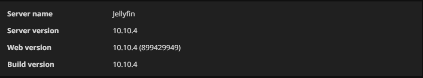

    Also after updating. I noticed this on dashboard:
    Normally on the web version it would say "10.10.4" not the last bit. Is this an artifact from the pronlem I mentioned above?
    Reputation: 463
    2025-01-22, 11:09 PM
    You should be ok using noble builds on oracular. With the caveat that there is the possibility that a dependency that Jellyfin relies on could update and break Jellyfin. It is unlikely, but something to keep in mind.
    Regarding the build number, try clearing your browser cache? If it is still there, it isn't anything to worry about.
