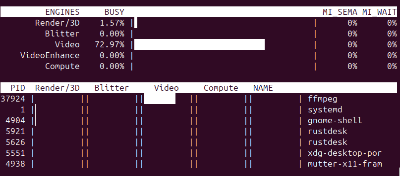

    Jey Forey
    Posts: 7
    Joined: 2025 Aug
    2025-08-20, 04:29 PM (This post was last modified: 2025-08-20, 04:46 PM by Jey Forey. Edited 2 times in total.)
    (2025-08-20, 03:55 PM)nyanmisaka Wrote: This indicates that all three video components in the transcoding process are performing below expectations. I suspect this is related to clock or driver issues.
    Can you disable the Intel iGPU's power saving mode RC6 or something similar in the BIOS to see if that changes anything?
    I have the MSI Mag Z890 Tomahawk Wifi motherboard, they have a search function for settings and unfortunately there were no results for RC6 or Power Saving that are related, I also went looking through the settings manually but could not see a power related option for the iGPU.
    Just ran a CPU bechmark (Geekbench) and the CPU was at or above the average.
    Hoping it's not a limitation of this motherboard that quicksync would underperform.
    I tried disabling RC6 within linux by using the following in the grub config but that didn't work either:
    GRUB_CMDLINE_LINUX_DEFAULT="quiet splash i915.enable_dc=0"
    You mentioned a potential driver issue as well?
