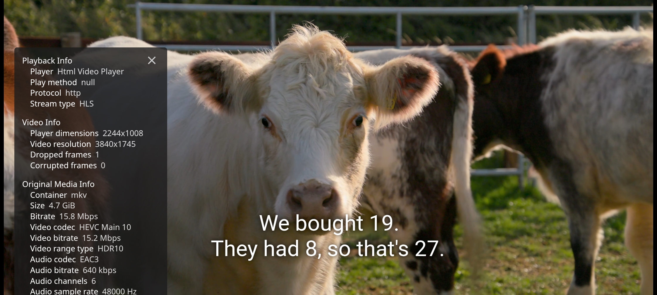

Hello. After I start playing a movie on jellyfin, after a while, the playback stops. I'm using the jellyfin app on PC and phone. This problem occurs when transcoding. Sometimes it takes 5 minutes, other times 10 to 20. After the playback freezes, the whole container is slow and is responding very slowly to commands in terminal. If I want to do anything with it I have to restart it from proxmox. Jellyfin version is 10.10.7. I've attached a photo of the resources used once the freeze occurs.
On the android app, in the first picture playback works, in the second picture the playback stops, in the 3rd picture after it stopped, at playback method it says null.
My setup relies on a container with jellyfin installed on a proxmox server. To set up the container I used the proxmox VE helper script for jellyfin media server. I passed through a nvidia gpu to use nvidia nvec. To reduce wear, I added a 16GB ramdisk mount point inside the container to reduce wear on the ssd.
Specswise I have a i5 3470, 32GB of ram, a nvidia 1060 6GB, a 512GB ssd whith the proxmox server install and the jellyfin container and a 4TB ssd with movies and tv shows.
