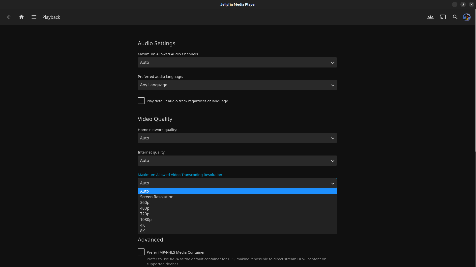

    2024-02-26, 09:44 PM
    Hmmm.  I'd assume the PC client would be able to handle down-scaling the content when it is larger than the display.
    What happens when you set the max transcode resolution to 1080P?
    Settings > Playback (not the dashboard).
    TheMoltenJack
    2024-02-26, 10:19 PM
    Still same error.
