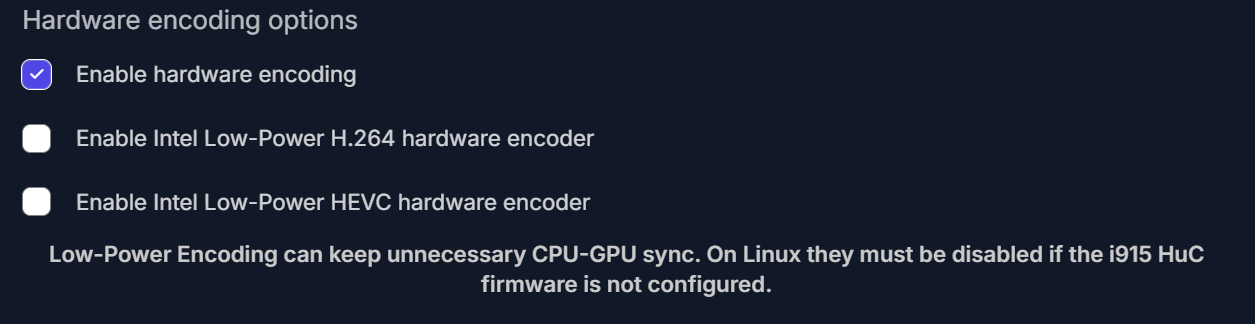

    I have Jellyfin running on Truenas Scale 24.10.2 with a Intel Arc a310, hardware transcoding is enabled and so far everything works perfectly.
    My question is if I can enable the Low-Power H.264 hardware encoder and Low-Power HEVC hardware encoder?
    I have tried to find out if the firmware is configured correctly on Truenas but haven't been able to find the information.
    Any help would be great!

    You should enable both. It is required for Intel Arc when encoding to those codecs.
    On the TrueNAS command line run this command and share the output.
    sudo dmesg | grep i915
    Depending on the uptime of your server, it may have aged off the messages we are looking for. But you can also go to /var/log and run a grep command to search the archived dmesg log files.
    grep i915 /var/log/dmesg.1
    zgrep i915 /var/log/dmesg.*.gz

    This is the output:
    [    9.657297] i915 0000:03:00.0: [drm] VT-d active for gfx access
    [    9.657400] i915 0000:03:00.0: vgaarb: deactivate vga console
    [    9.657426] i915 0000:03:00.0: [drm] Local memory IO size: 0x00000000fd000000
    [    9.657428] i915 0000:03:00.0: [drm] Local memory available: 0x00000000fd000000
    [    9.673887] i915 0000:03:00.0: vgaarb: VGA decodes changed: olddecodes=io+mem,decodes=io+mem:owns=none
    [    9.681089] i915 0000:03:00.0: [drm] Finished loading DMC firmware i915/dg2_dmc_ver2_08.bin (v2.8)
    [    9.686444] i915 0000:03:00.0: [drm] GT0: GuC firmware i915/dg2_guc_70.bin version 70.20.0
    [    9.686448] i915 0000:03:00.0: [drm] GT0: HuC firmware i915/dg2_huc_gsc.bin version 7.10.15
    [    9.695472] i915 0000:03:00.0: [drm] GT0: GUC: submission enabled
    [    9.695475] i915 0000:03:00.0: [drm] GT0: GUC: SLPC enabled
    [    9.695736] i915 0000:03:00.0: [drm] GT0: GUC: RC enabled
    [    9.735937] [drm] Initialized i915 1.6.0 20201103 for 0000:03:00.0 on minor 0
    [    9.737003] snd_hda_intel 0000:04:00.0: bound 0000:03:00.0 (ops i915_audio_component_bind_ops [i915])
    [    9.737423] i915 0000:03:00.0: [drm] Cannot find any crtc or sizes
    [    9.769103] i915 0000:03:00.0: [drm] Cannot find any crtc or sizes
    [    9.794456] mei_gsc i915.mei-gscfi.768: FW not ready: resetting: dev_state = 2 pxp = 0
    [    9.794515] mei_gsc i915.mei-gscfi.768: unexpected reset: dev_state = ENABLED fw status = 00000345 84670008 00000000 00000000 E0020002 00000000
    [    9.795252] mei_gsc i915.mei-gsc.768: FW not ready: resetting: dev_state = 2 pxp = 2
    [    9.795312] mei_gsc i915.mei-gsc.768: unexpected reset: dev_state = ENABLED fw status = 00000345 84670008 00000000 00000000 E0020002 00000000
    [  10.201830] i915 0000:03:00.0: [drm] GT0: HuC: authenticated for all workloads
    [  10.201840] mei_pxp i915.mei-gsc.768-fbf6fcf1-96cf-4e2e-a6a6-1bab8cbe36b1: bound 0000:03:00.0 (ops i915_pxp_tee_component_ops [i915])
    What should I do then?
    2025-02-11, 06:14 PM
    That looks ok. You should be able to check both low power encoding boxes.
