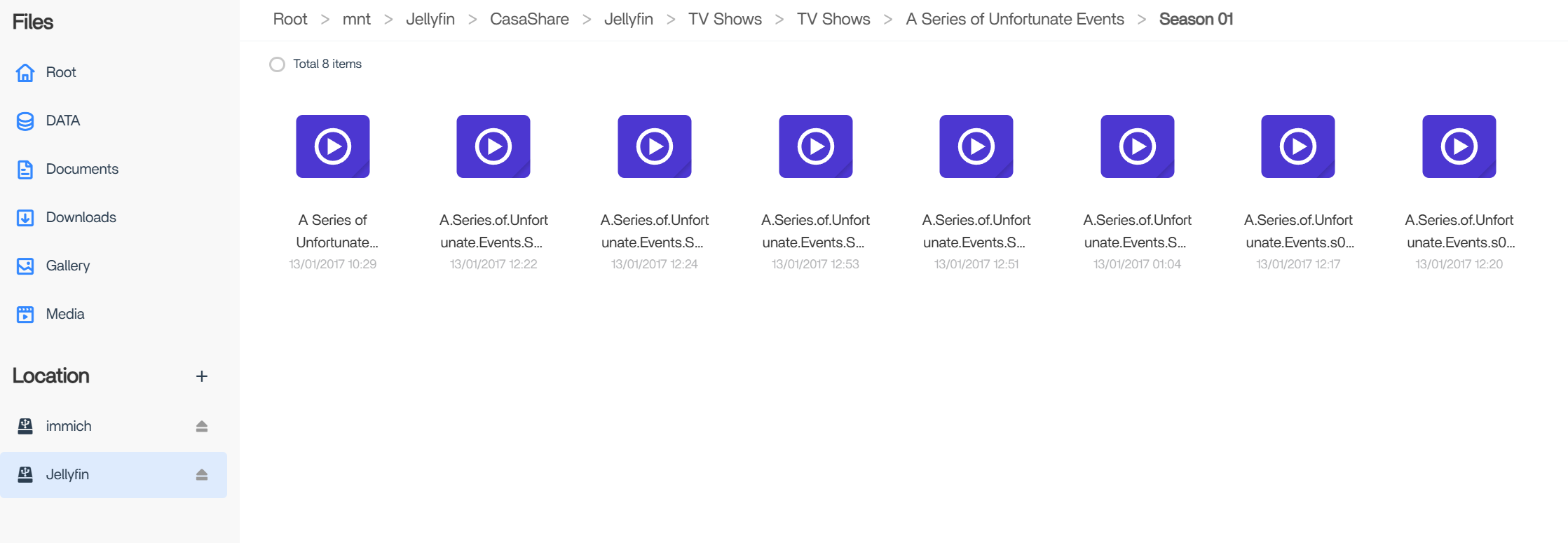

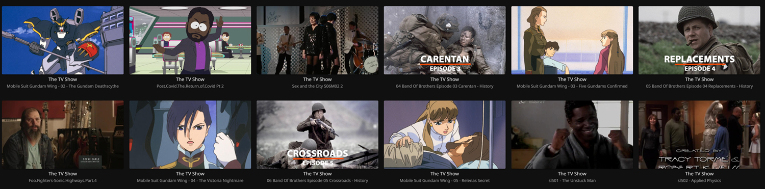

    I am new to this and this is my first time posting but I am stuck. I am using a zimaboard running CasaOS I have an external hardrive that has movies and TV shows. I am trying to set up jellyfin, which is populating the movies correctly but with the tv shows it seems to be adding them all under one tv show called "The TV show" when i go over to the episodes tab I see all the episodes from all the tv shows I have on the external drive, i have attached pictures to hopefully help.

    Can you share how you've configured the TV show library and how your files are organized?

    Hey thanks for replying. again really new to all this so hopefully this is what your asking for. I have attached photos of my tv show library config as well as made a post of my logs in privatebin

    It looks like you have two "TV Shows" folders? If your library is using the top level "TV Shows" folder, that would probably be why you are having issues. You would either needs move everything up one directory to the first "TV Shows" folder or use the lower "TV Shows" folder as the library root.

    Yeah that worked! cant believe i missed that...Thanks alot for your help!
