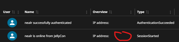

    The user "Jellycon" does show up in my server dashboard, but there is no IP address assigned (see screenshot).
    For some reason the batocera/kodi/rpi is not sending out network information.  Seems mostly likely it's a network setting on the rpi software.
    JR
