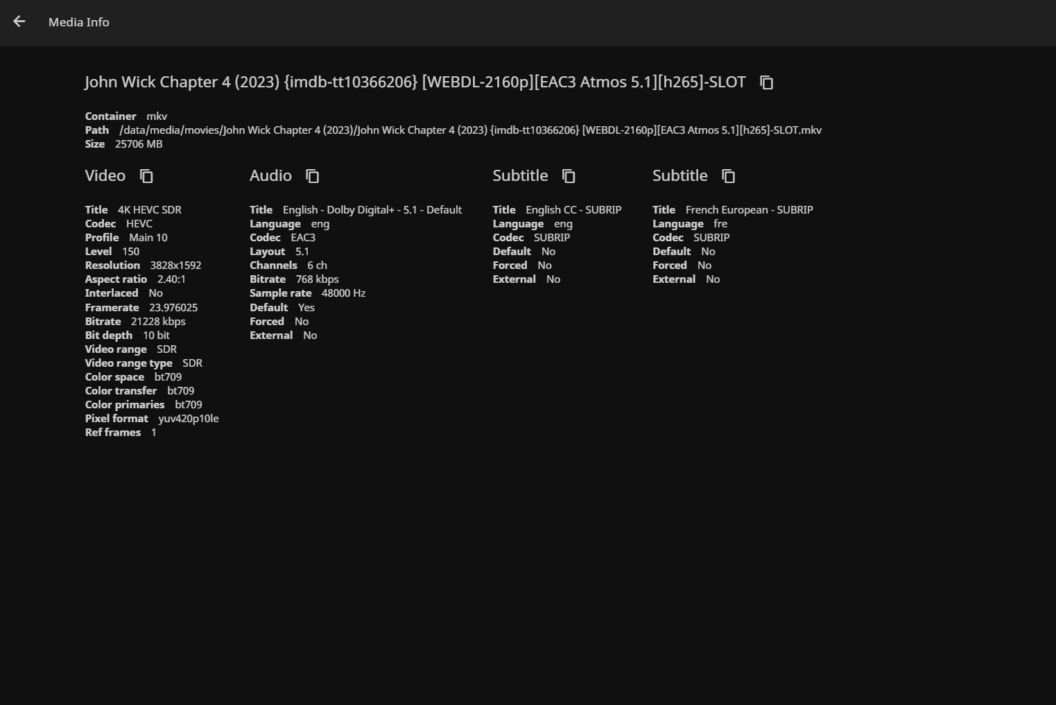

    Hello everyone,
    I have been using Jellyfin for sometime, and I finally got surround sound setup on my apple TV.
    So if I play John Wick Chapter for.  its a 4k 5.1 or 7.1 file.  I get no sound out of the rear speakers in my system.  If I play that same file on my Iphone and air play it to the apple TV I get surround sound.
    Also if I play things through youtube or netflix that are surround sound from the apple tv in question I get surround sound.
    When playing straight from the apple TV, Jellyfin reports that the client is fully compatible and is direct streaming it.  When playing from the Iphone it is transcoding it
    I am happy to provide any info needed to help solve this issue, and any help is greatly appreciated.
    Thanks.

    another problem with a 'web-dl'
    i wonder if you would experience the same issue with a real blu-ray release with TrueHD Atmos instead of EAC3
    who knows where that copy you have has been or what's been done to it
