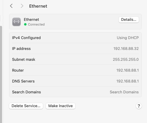

    Working with a Mac as my local server, in the Apple TV app I have tried the IP listed in my Network settings, with the ":8096" suffix, and a host of others.
    What happens is when I click "connect", nothin' happens.

    The address "http://192.168.1.3:8096" is just an example. You should replace it with your own local IP address. Could you share the address you're entering? Your local IP is not sensitive information; it's your public IP address that you need to keep private.

    The IP for the Mac is (supposedly?) 192.168.88.32, and the router is 192.168.88.1.
    I follow those with the ":8096", correct?
